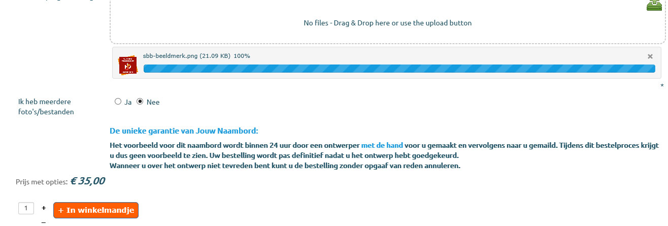

Is there anything known about the Hikashop ajax upload field not working in Explorer 11 and Edge? Several customers complain about the upload field is freezing during upload.

Yes, I have the same problem when testing on my own computers.
This is a link:
www.jouwnaambord.nl/naamborden/plexiglas-naambord-zakelijk
works fine in Chrome and Firefox. Freezes in Explorer 11 and Edge.

Works good for me.
IE11 : pasteboard.co/8zhr3mtCE.png
Edge : pasteboard.co/8zjtmGh23.png

Well maybe with a very small file (< 100kb)? Can you try with a 1Mb jpg?

So I do see the problem on your website with a big file:
take.ms/EKqTF
But we also see an error in the console.
SCRIPT5007: Unable to get property 'H5Form' of undefined or null reference
html5fallback.js (1,2225)
And there is the report of the issue in the Joomla CMS : github.com/joomla/joomla-cms/issues/3023
But that's only on your website. I tried the same custom field on a product page on local with edge and it worked fine:
take.ms/vuQC8
Because we do not have the html5fallback.js in our side.
