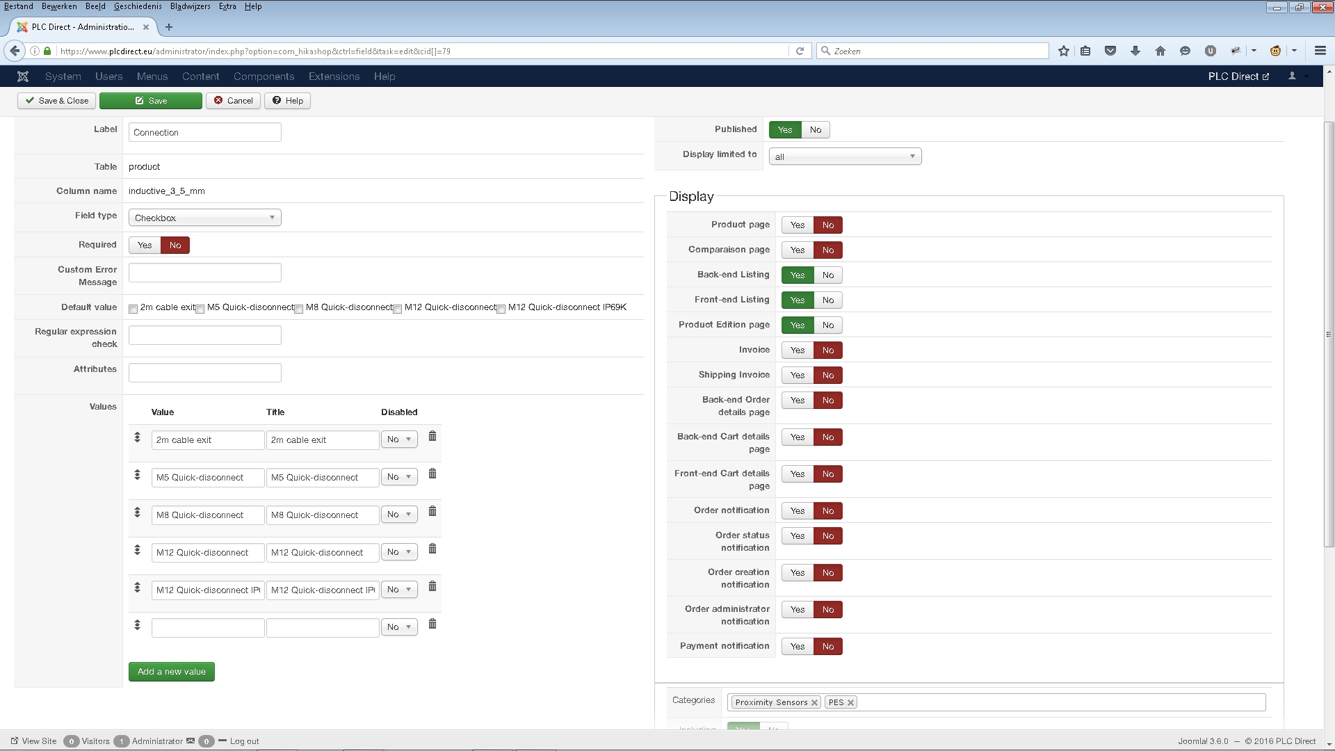

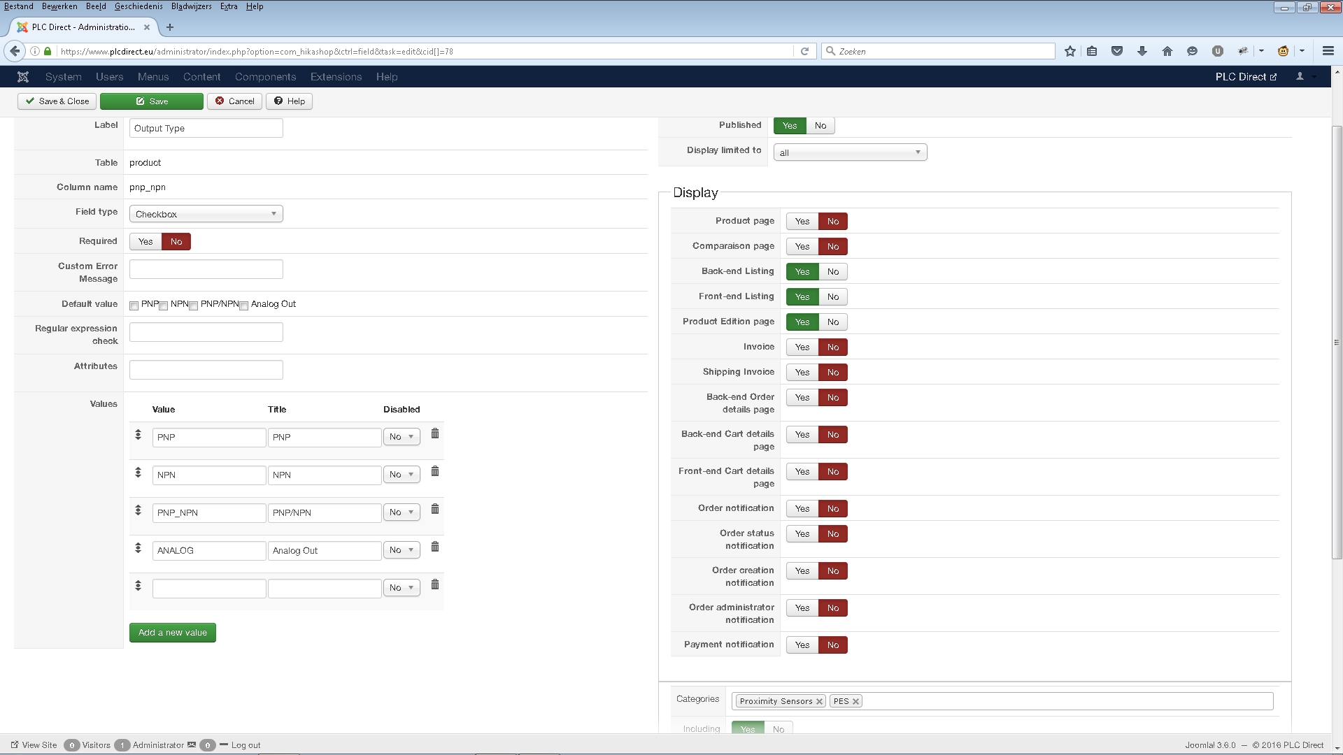

2. I suppose that the problem must come from the values that you're using in your custom field which must overlap and thus the filter system finds a match for the selection of the value.
Could you provide a screenshot of the setting of the custom field of that output type filter ?

2. See the attached files.

if(!empty($selected) && is_array($selected) && (in_array($val[0], $selected) || strpos($selected[0], $val[0]) !== false)) {
						$checked = 'checked="checked"';
						if($type == 'radio') {
							$deleteButton = '  '.parent::getDeleteButton($filter, $divName, '', $html, '', true, 'field_'.$filter->filter_id.'_'.$key.'_'.$divName);
to:
if(!empty($selected) && is_array($selected)){
						foreach($selected as $selectedElement){
							if(preg_match('#^('.$selectedElement.'|.*\:\:'.$selectedElement.'|'.$selectedElement.'::.*)$#',$val[0],$match)){
								break;
in the file administrator/components/com_hikashop/classes/filter.php and that will make the system properly select the elements after the search. Regarding the fact that you see all the values after the filter, that's normal:
You're in dynamic display mode where the filters display all the values of the products in the listing. Since there are no products after the filtering, there are no values. So instead of not displaying any values in the filters, it displays all of them.
