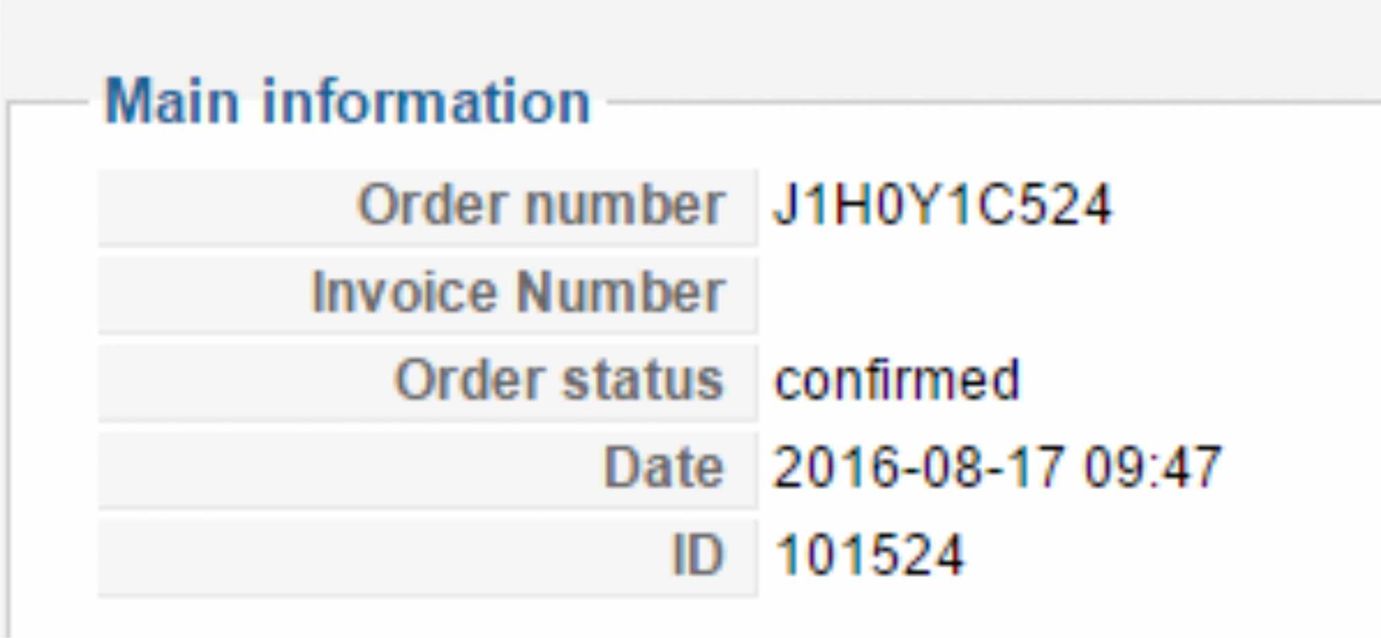

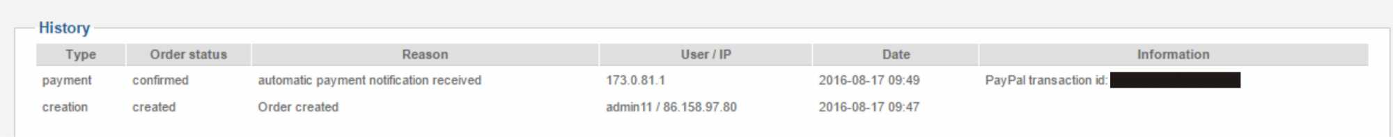

I have tried what you suggested, my payment log file reads-
"Could not load any order for your notification Could not load any order for your notification Could not load any order for your notification Could not load any order for your notification Could not load any order for your notification Could not load any order for your notification Could not load any order for your notification Could not load any order for your notification"
Paypal is communicating - the transaction is logged, and the status of the order changed to confirmed (see images)
However, an invoice is not being generated, and the stock is not being removed (I am having to do this manually to keep the stocks accurate)
Will the latest Hikashop uodate still work with my version of Joomla? I will update if it will.
Last edit: 9 years 10 months ago by GB11. Reason: forgot to add images
