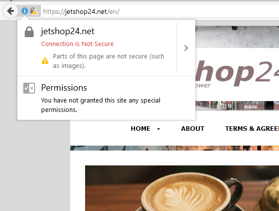

  • Posts: 128
9 years 11 months ago #249149
Activation worked flawlessly. Thanks.
Yet my browser shows that its still not secure. Any advise?
Thanks again for your help.
Thomas
Last edit: 9 years 11 months ago by thomasf.
  • Posts: 128
9 years 11 months ago #249162
I got it working. I found out that some images were not https but still http and an advert was not secure. Did that changes and it worked now.
great stuff.
