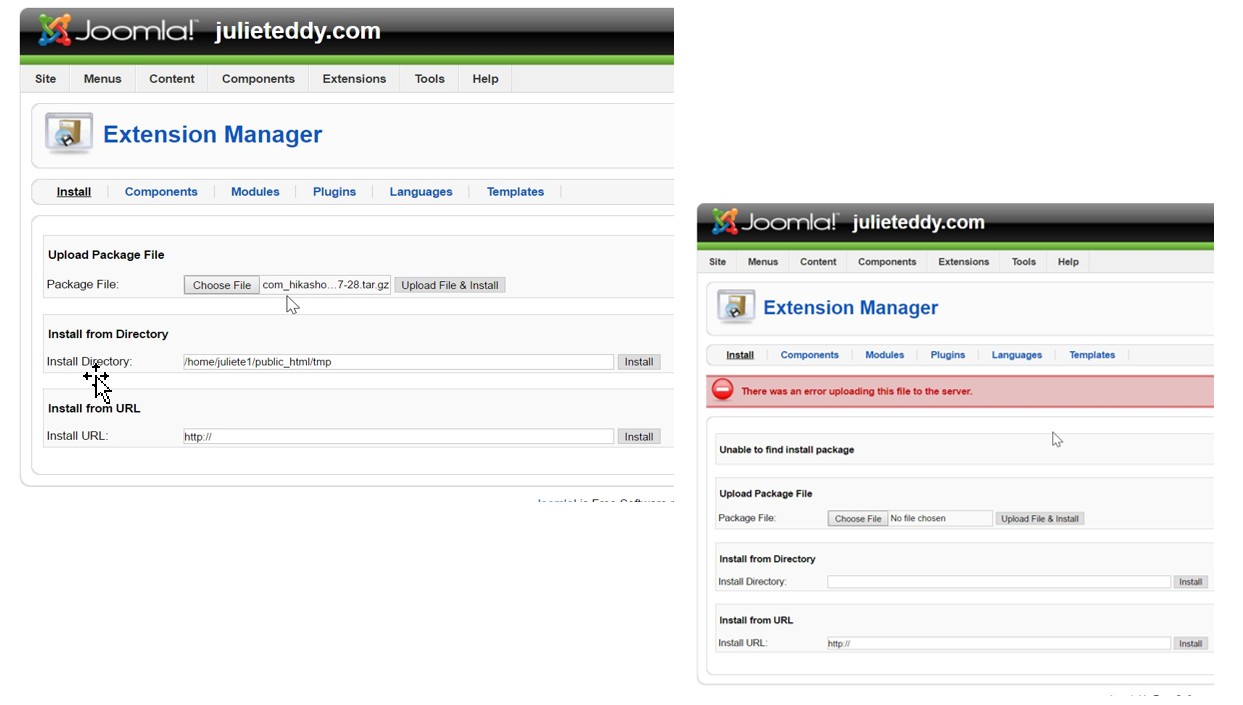

i downloaded latest Hikashop and save it in local,
i go to joomla admin to upload it from local, -- >extension-->install/uninstall.
a massage show 'There was an error uploading this file to the server' (refer 592 attached)
which step do i overlook.

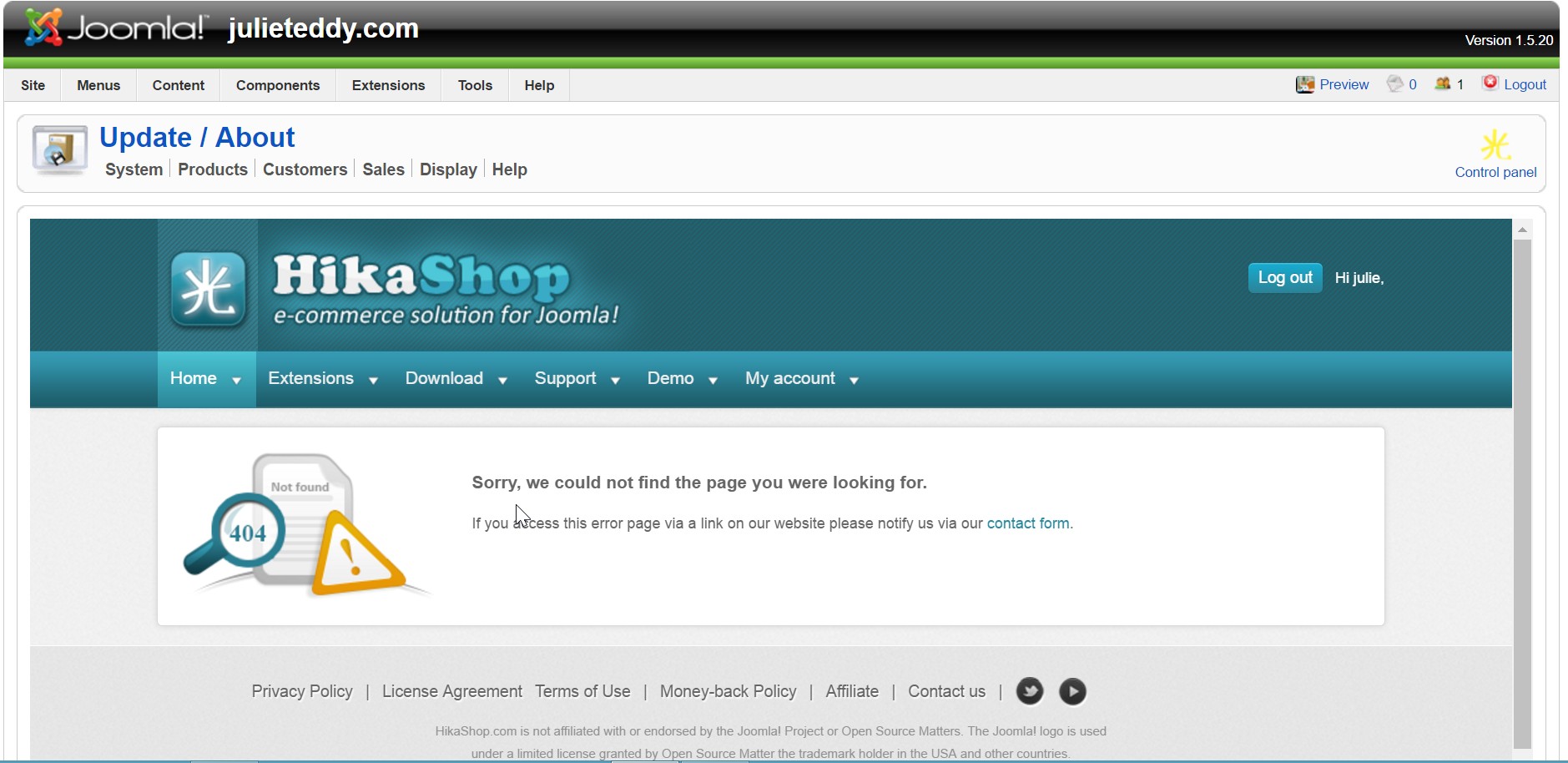

i try to do it fro joomla admin, -->component--.Hikashop-->update/about,
i have other error massage (refer593 attached)
julie

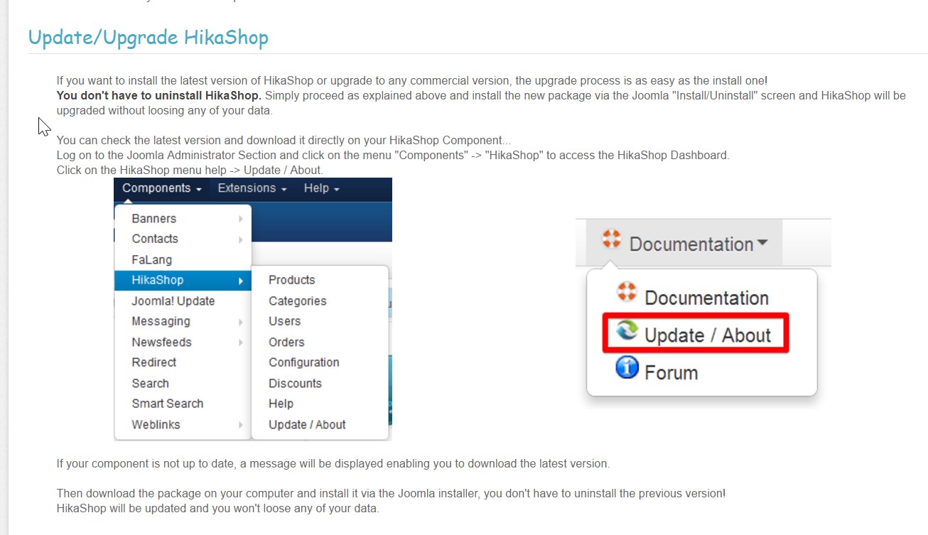

9 years 11 months ago #250454
Please read that documentation page :
www.hikashop.com/support/documentation/5...-install.html#errors
About the "update" page ; I think that because you're using a very old version of HikaShop (6 years ago), the link might be a dead one.
www.hikashop.com/support/documentation/5...ashop-changelog.html

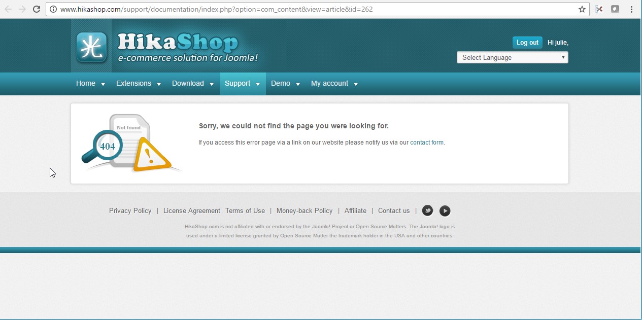

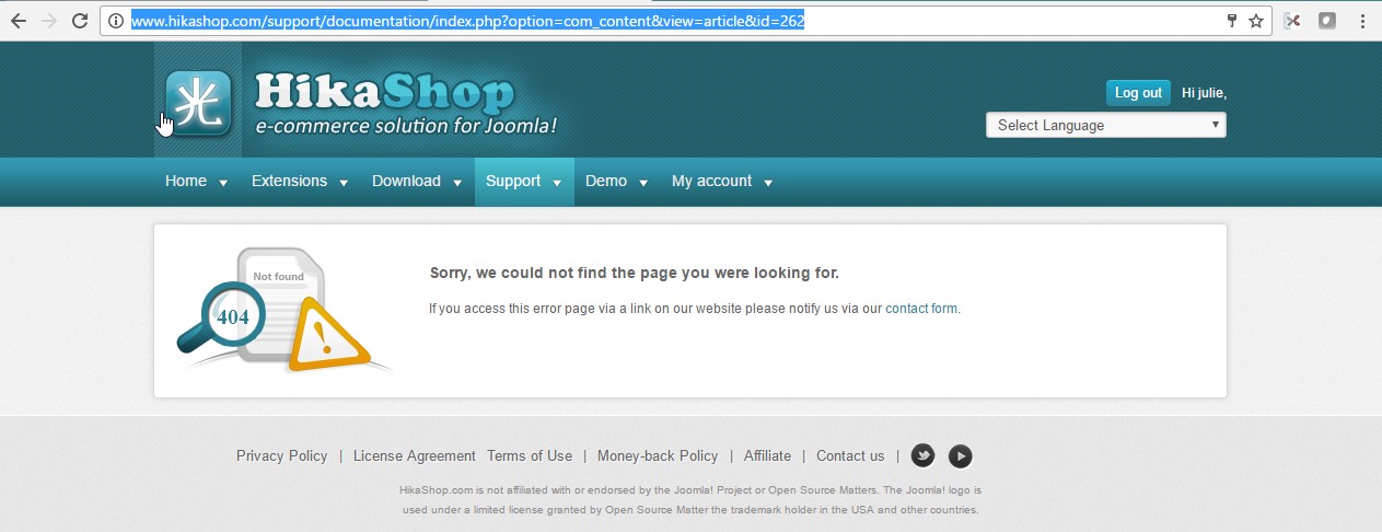

  • Posts: 30
9 years 11 months ago #250776
i clink the link, can not find the page.
i get this message. please refer attached.
thank you.
julie
  • Posts: 86082
  • Thank you received: 14194
9 years 11 months ago #250794
The links work fine but you need to click on them in the forum. The links in the email notification you got are truncated and won't work. That's a bug of Kunena. We're currently working on updating it which will fix that bug.

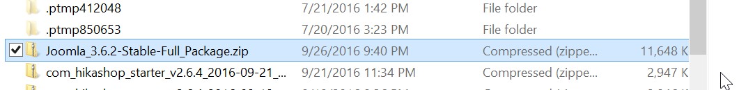

  • Posts: 30
9 years 11 months ago #250821
i read the document,
i need to do it from joomla installer correct ? as the page mension (attached)
i install joomla installer in local cpu , do it from my laptop ?
or i need to go to my webhosting to do it,
julie
  • Posts: 86082
9 years 11 months ago #250861
We're not talking about updating Joomla here but HikaShop. So it's the install package of HikaShop that you want to use.
The error 'There was an error uploading this file to the server' can be circumvented by doing an install via FTP of the HikaShop install package:
www.hikashop.com/support/documentation/5...-to-install.html#ftp
If you have difficulties to install HikaShop, you may want to try to install it via FTP.
This way, Joomla won't have to upload the HikaShop package on your website so the installation will be much faster.
Extract your HikaShop package in a folder called "hikashop" on your own computer.
Open your FTP software (FileZilla for example), connect to your website and upload the folder "hikashop" in the temporary folder of your website : /tmp/
Go to your Joomla Installer manager on your website backend and specify the path of your folder in the input "Install from Directory" : "\home\...\tmp\hikashop".
Click on the button "Install"... the install process should be much faster and will enable you to successfully install HikaShop.

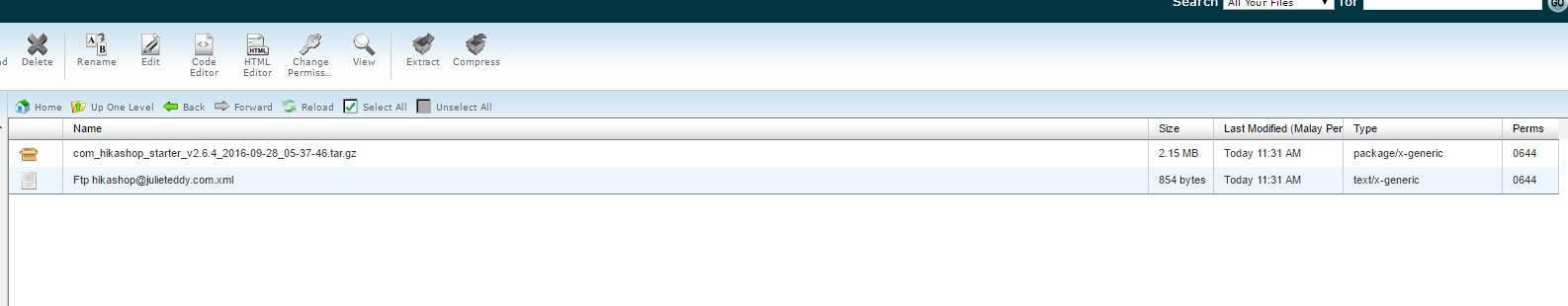

  • Posts: 30

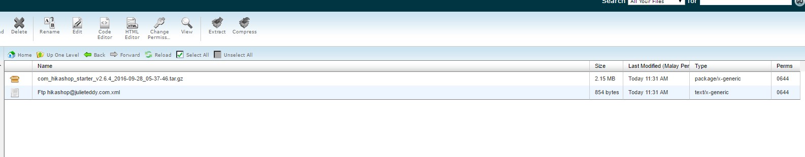

9 years 11 months ago #250925
i have created a ftp account, upload the latest ver of hikashop to it,
go to joomla admin to upload the file from ftp, but it fail.
i attached my step to upload and files in my ftp account for your reference.
jack
note: my joomla is 1.5
  • Posts: 86082
9 years 11 months ago #250952
As explained in the instructions I gave you, you need to first extract all the files and folders of that zip on your local computer and upload them all via FTP in the tmp folder.
Here you uploaded the zip directly, that's why it doesn't work.

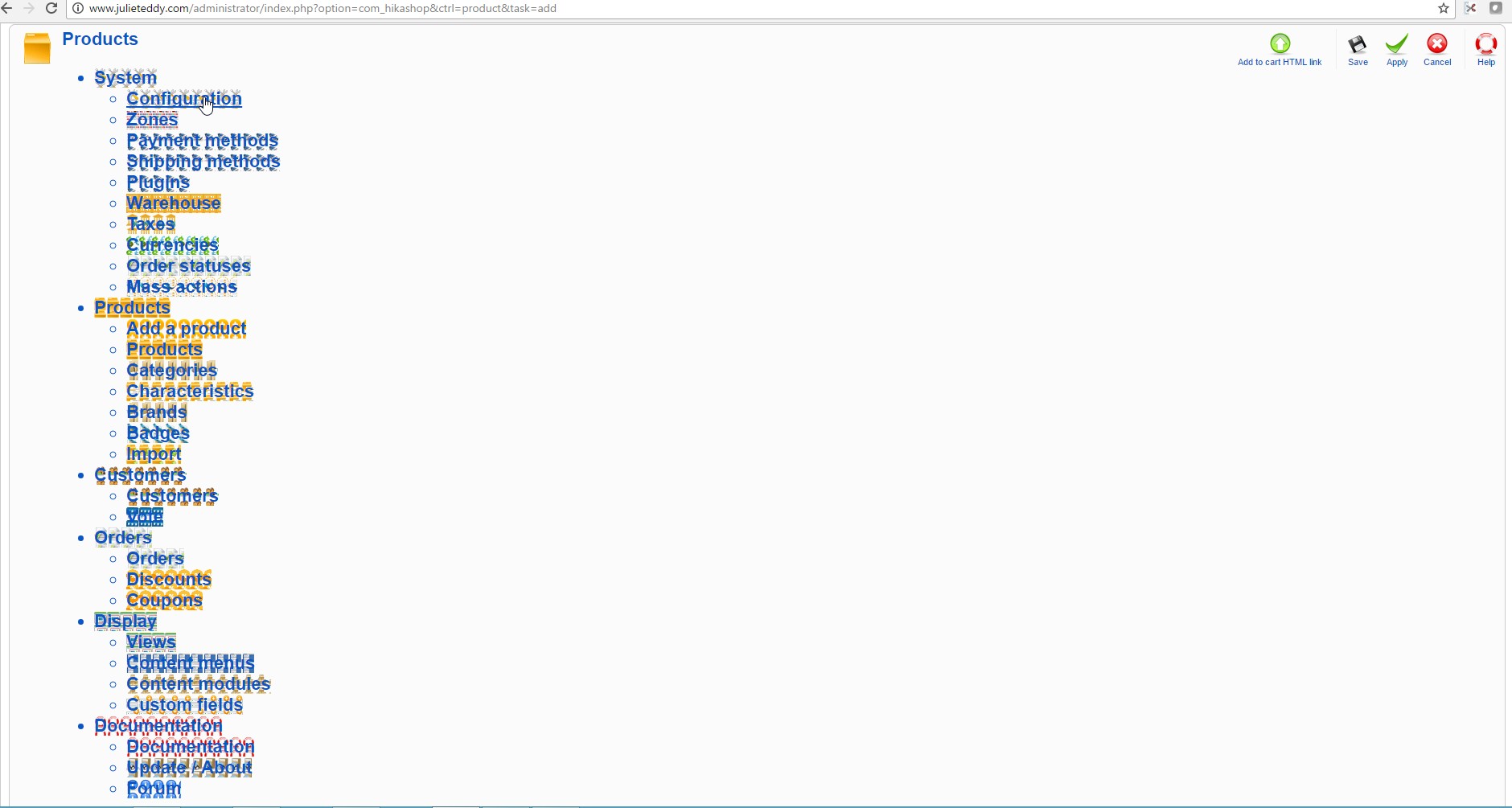

  • Posts: 30

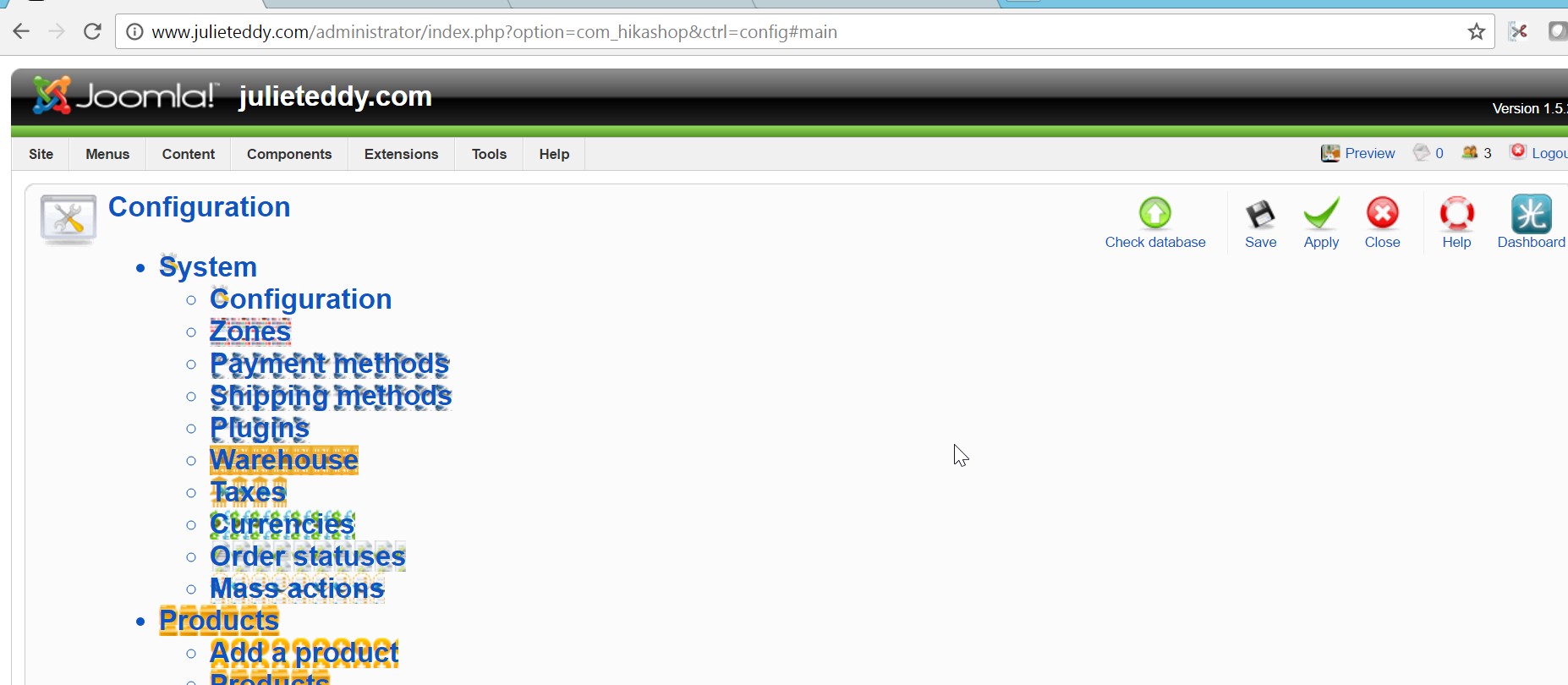

9 years 11 months ago #251021
hi,
thank you for you instruction, i manage to update to latest ver.
the first page look odd (625), any thing goes wrong on my uplaoad ?
jack

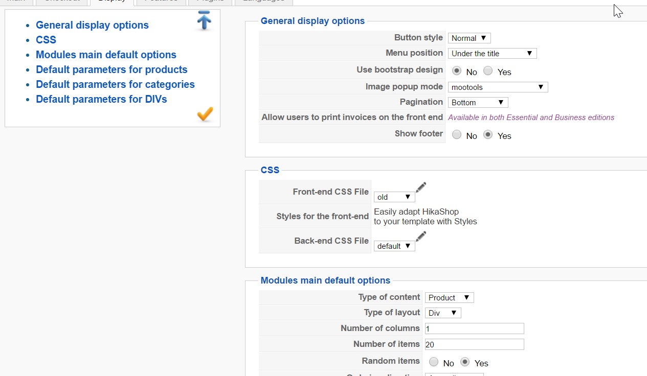

  • Posts: 86082
9 years 11 months ago #251057
Make sure that you have configured the "backend CSS file" setting of the Hikashop configuration to "default" and clear your browser's cache and it should display properly.
  • Posts: 30
9 years 11 months ago #251088
i change the backend CSS to default. clear browser catch.
the display still the same.
jack
  • Posts: 86082
9 years 11 months ago #251094
Then try changing the "menu position" setting to "above the content" in the HikaShop configuration.
