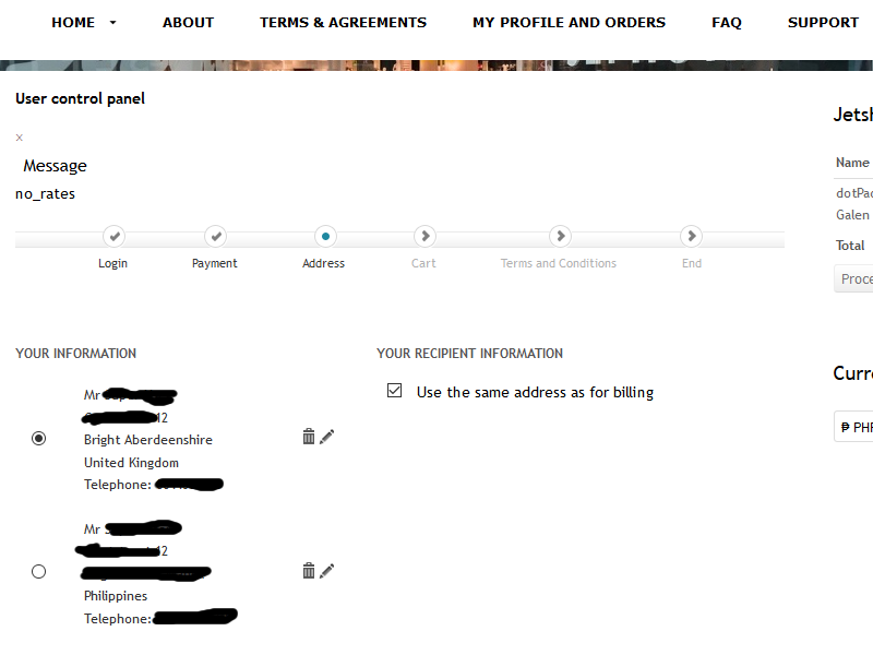

when a country is not covered by our shipping methods an alert message appears above of the check out. It shows: Message
no_rates
Basically that is fine, but no_rates look not good. How can I change or edit the no_rates message into a more suitable massage?

thanks for your reply. See the screen shot about how it looks. The line you showed containing no_rates, is in shipping.php
if(empty($rates)) {
$errors = JText::_('NO_SHIPPING_METHOD_FOUND');
$this->errors = $errors;
return $usable_methods;
In en-GB.com_hikashop.ini I can also find the corresponding language file line: NO_SHIPPING_METHOD_FOUND="No method found"
So all seems to be there but it stops at no_rates
Thanks and regards
Thomas

Yes that's right and that's ok. Some countries cannot be delivered. My problem is not that a shipping method is not found, but that I can't modify the message through the language file, as it gets stuck at no_rates. S instead of no_rates I want a modified message. But it won't get it from the language file.
9 years 11 months ago #250805
Hello Thomas,
Thank you for your feedback, we'll fix it as soon as possible.
For the moment the best solution for you will be to directly add that line through your translation file :
NO_RATES="No method found"
The following user(s) said Thank You: thomasf
