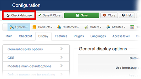

Did you try the "Check database" process, here : In Components => HikaShop => Configuration
If that don't solve your issue try to update your HikaShop version because we just add a patch in our lastest version, that may solve your issue.
