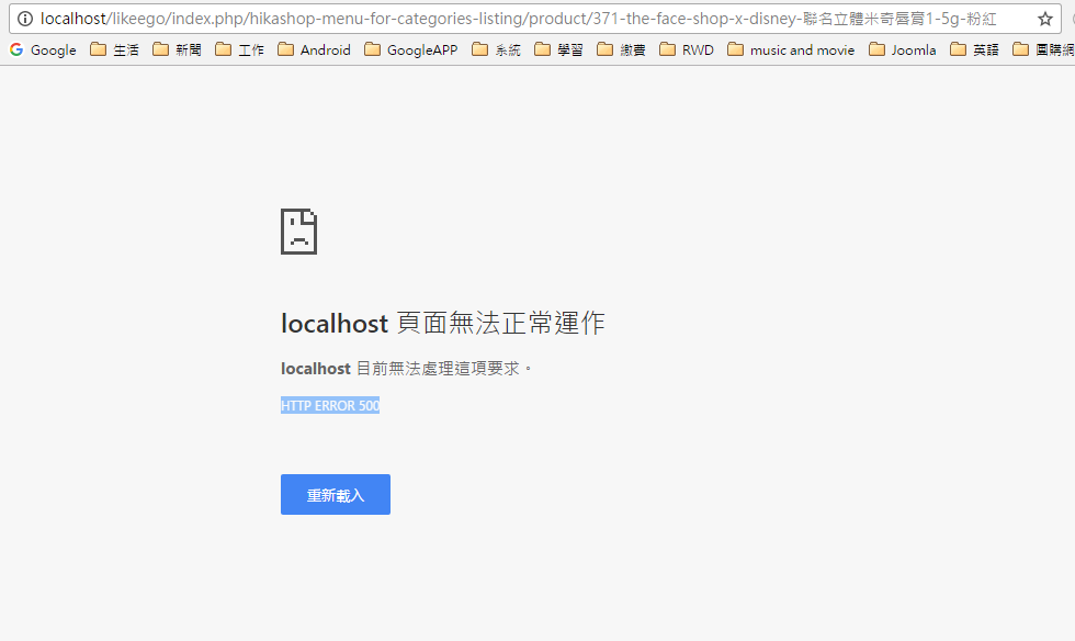

-- Joomla version -- : 3.5
-- PHP version -- : 5.5.12
-- Error-message(debug-mod must be tuned on) -- : HTTP ERROR 500
hi,
After testing the upgrade of my developing site, I upgrade me living site, and the tragedy happen.
When I clicked on a product in the product list, it didn't show the product detail but the error 500.
I really have no idea how to fix this, could you give me some suggestion.
Best regards
Scott

If you turn on the debug mode and the error reporting in your Joomla configuration, you can see these errors:
take.ms/uzYrt
As you can see, they come from a custom plugin productsImgFolders which tries to call a function isVendor which isn't there.
So it's not a bug in HikaShop as far as I can see.
You'll have to check with the developer of that plugin in order to fix the problem.

9 years 10 months ago #251499
Thank you so much, that was cause our own developing member.
We will handle this kind of error by our-self in the future.
