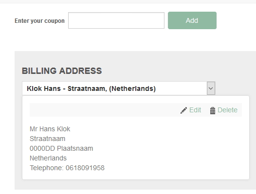

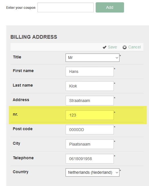

I added a custom field to the address. When I edit the address in the checkout on the frontpage the number field is there. When I save the address the number field is gone. How can I add this number field to the address box on the checkout page? I hope you help me with a solution!

You need to edit the "address_template" view file for both your frontend and your backend template via the menu Display>Views in order to add the corresponding tag for your custom field.

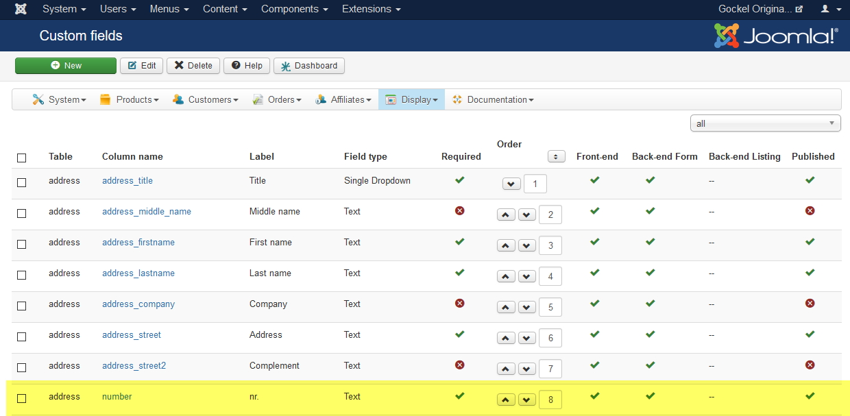

What code should I use? The field name is: number and the id: 28

Look at the other tags. You can see that you just need to put the column name in between brackets. Like that: {number}
