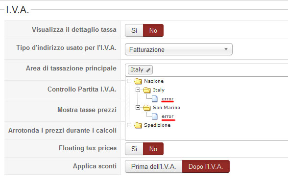

i have another problem, now with taxation area, see the image in attachment.
I want to configure the system to allow buying only from Italy.
Then, in the areas page, i turned off all the country and i published only Italy.
I turned off also all the state except those related to Italy.
I have only one taxation area: Europe.
I don't have shipping area.
When i try to select the taxation area in the main configuration, i receive the error in the image.

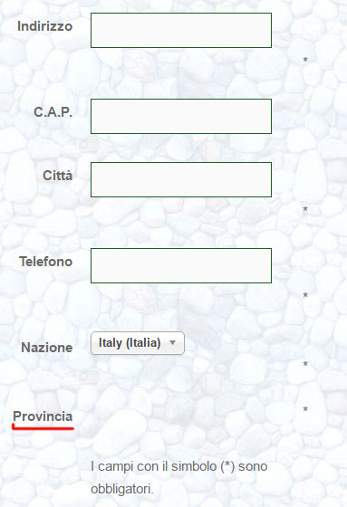

Then, if i try to make a ch eckout with a test user, the system don't show the state combo box like in the second image.

9 years 9 months ago #254145
The custom country field default value is another country that Italy in the database, that's why the states field is empty as the states of that country are unpublished.
Edit your custom country field, make sure that its address is set to Italy and save the custom field settings.
It should then display properly.
