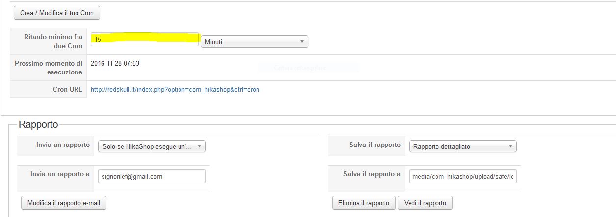

9 years 9 months ago #256258
Just to be sure, I have to change the setting in cron cofiguration of hikashop too, and change 15 with 1 in the screen shot below.
Correct?
FRank

  • Posts: 86082
  • Thank you received: 14192
9 years 9 months ago #256275
That's right.
