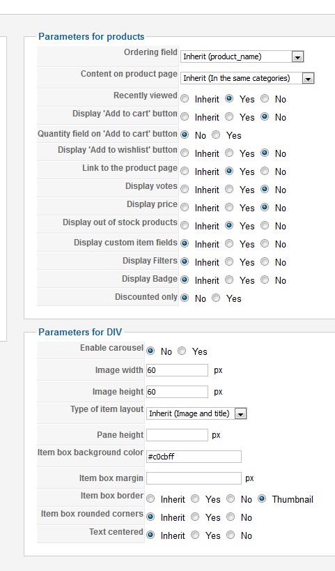

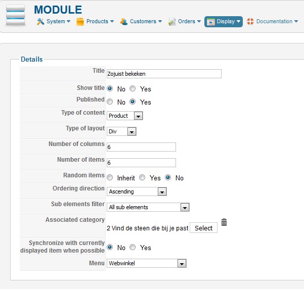

Attached are 2 screenshots of the configuration of the Recenlty Viewed module.
This configuration worked fine before the update.
I hope this helps.
Perhaps Hikashop 264 has some new options (since 233) I should check?
Udo

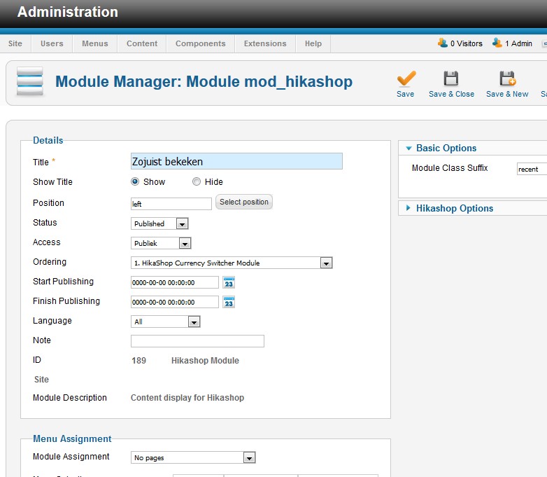

I only provided the Hikashop options (2 images). Attached are the Joomla options too.

  • Posts: 86081
  • Thank you received: 14192
9 years 9 months ago #255503
Then maybe it's because you have enabled it in the Joomla modules manager and thus it displays in a position of your template.

As I said previously, you only provided a part of the options of the related products module. The HikaShop options of the module is in two parts and you only provided the left part. I'm not talking about Joomla options.
So I still don't know how your related products module is configured.
It's normally quite simple: You install HikaShop, you add related products to your products, and the related products module is already configured to display properly the related products under the product page.
So if you don't see the related products, it's probably that either you disabled that module in the "modules under the product page" setting, or that the settings of the module have been changed in an invalid way.

  • Posts: 86081
9 years 9 months ago #255670
My bad, I didn't see the second screenshot in your previous message.
On top of that, I got confused with the message of Mohamed talking about the "modules under the product page" setting which is only useful for the related products module.
So looking at your screenshots of the module, it is correctly configured to display recently viewed products.
Make sure that the module is still published and disabled in the "modules under the products page" as this is not necessary.
Also, the synchonize setting should be turned off for that module.
And as it is a "recently viewed module", it will only display the products for which you already accessed the product page recently.
So make sure that you access one or two product pages before testing if you see it in the left position of your template where you set it.
And make sure that you turned off the caching on your website since otherwise, the module can display something different for each person and even for different pages for yourself. So once it displays with nothing in it, the cache would keep it empty.
