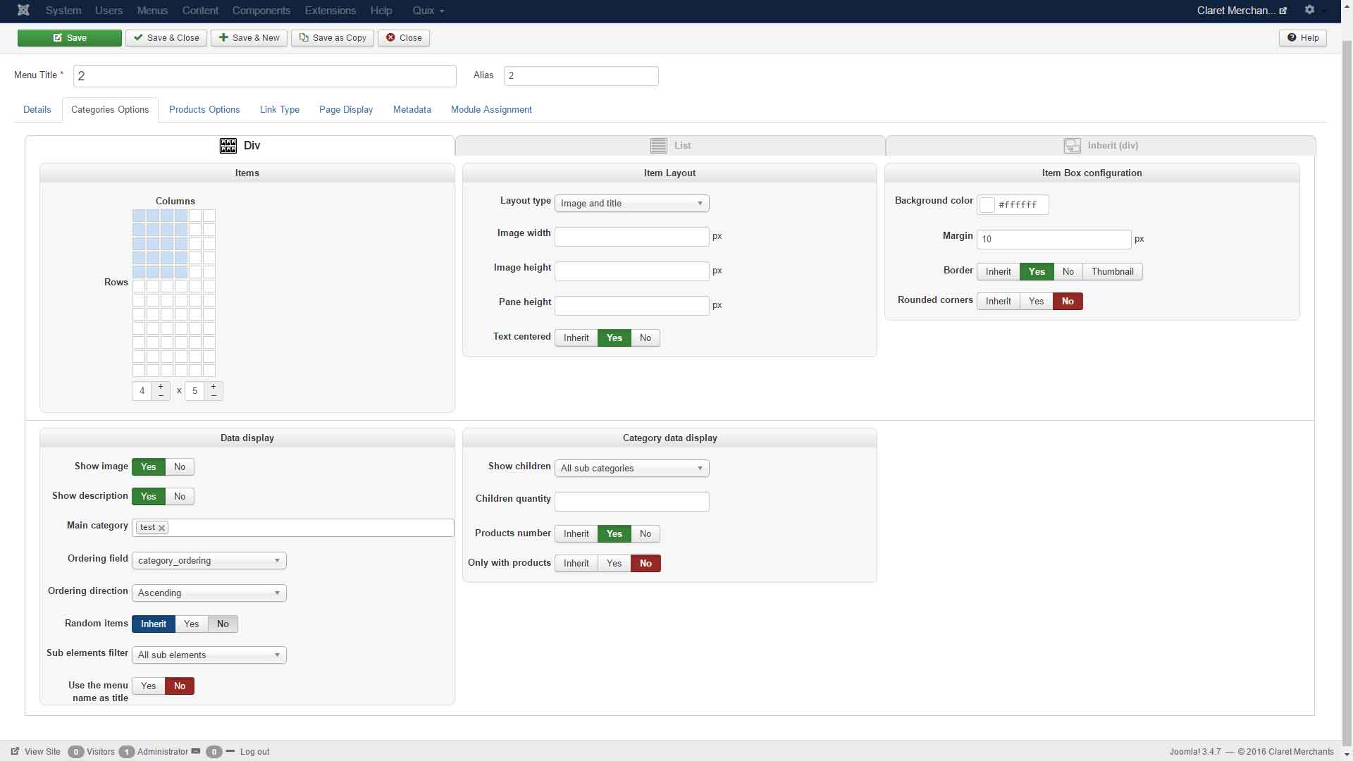

I updated from hikashop business 2.5.0 to 2.6.4. After saving a menu item type 'HikaShop » category' the page went blank! all products are gone.

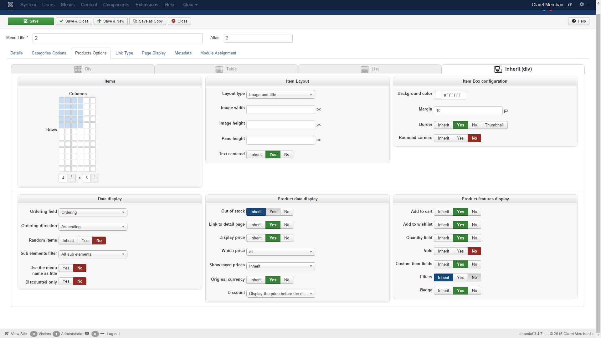

  • Paulhik
  • Topic Author
9 years 9 months ago #256513
Thanks for your reply.
About the url, i believe I did provide you with that? Please check the field "Url of the page with the problem"
Attachment not found
Should you need more printscreens or login please don't hesitate to ask.
So after saving an already existing menu items, without changing anyting, the corresponding page stopped showing the products.
Paul

9 years 9 months ago #256517
Based on your screenshots, the link should display a list of all the products of the category "test" or its sub categories.
Do you have an products associated with that category ?
If you do, then the issue likely comes from the file templates/YOUR_TEMPLATE/html/com_hikashop/category/listing.php
So in that case, try renaming that file and try again.
