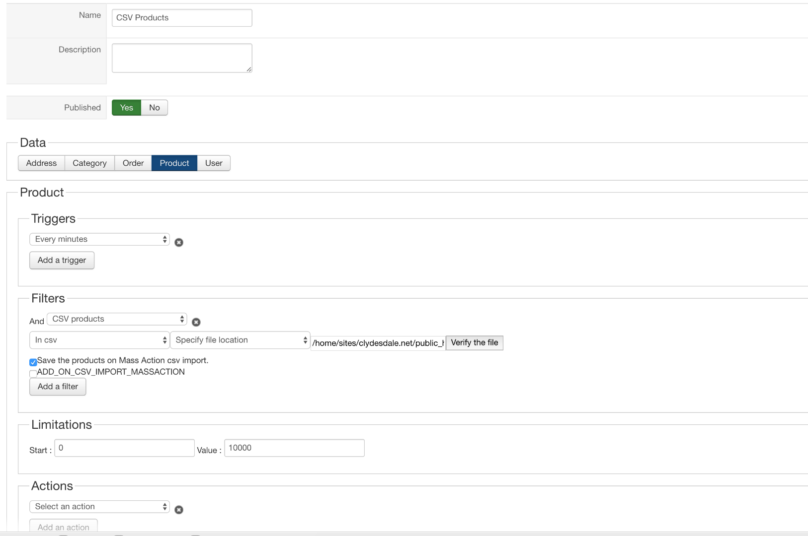

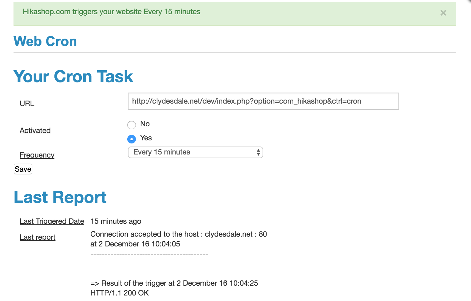

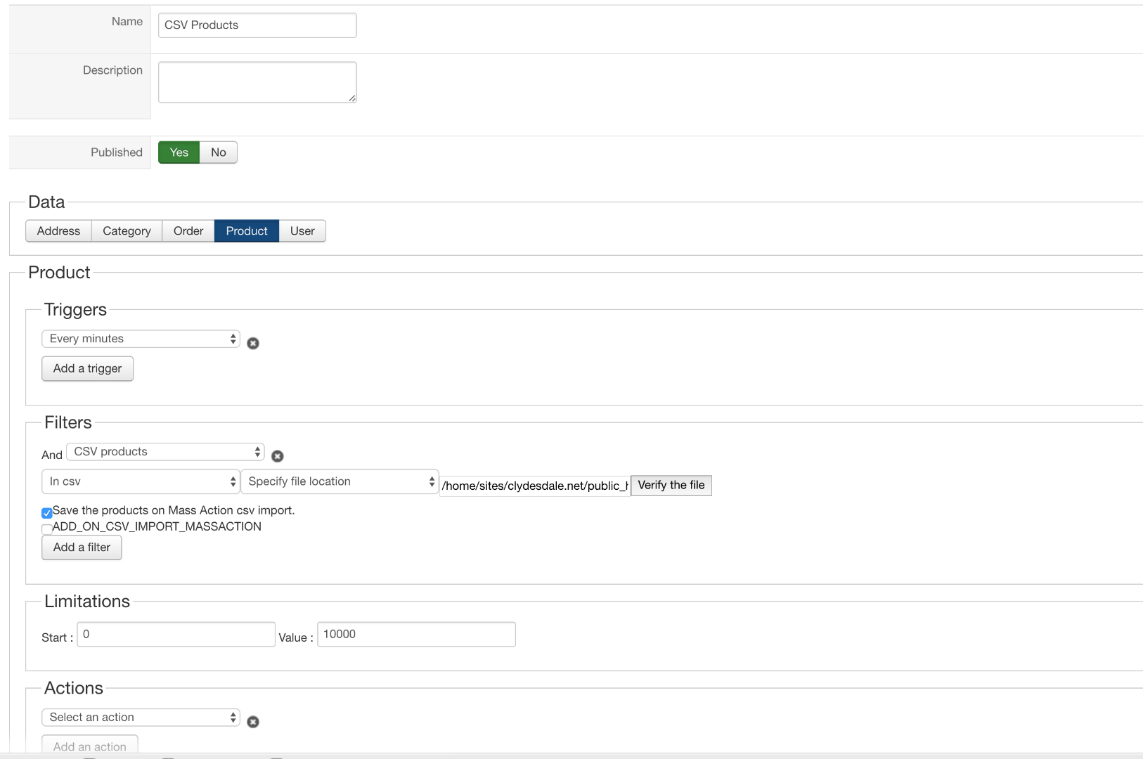

I a trying to setup a mass action so a CSV is pulled in from the server every so often so that I can update some details on my products. I have just created a cron job. Then setup a mass action for the file location etc. But nothing seems to be happening.
The cron job is saying its triggering but no prices are getting updated.
I have supplied a few screenshots of my settings.

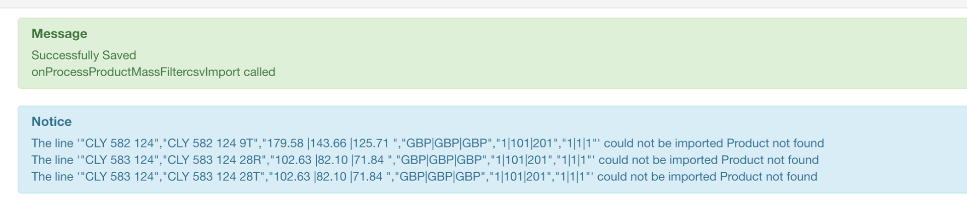

  • Posts: 256
9 years 8 months ago #256889
here is a screen shot of what appears. I imagine the reason why those other products didn't import is because they have nothing to replace.
  • Posts: 86081
  • Thank you received: 14192
9 years 8 months ago #256891
So you mean that you had other products in the CSV ?
Did they get updated ?
Could you provide a copy of the CSV you're using ?
It's normal that you got these products not imported lines since you didn't check the checkbox of the filter to import products not found.

  • Posts: 86081
9 years 8 months ago #257035
I would recommend removing the product_parent_id column from your CSV.
If you have it, then the system expect to have the parent row also in the CSV and also a column for each characteristic with the values of each variant for each characteristic, etc.
So since you only want to update the variants, data, and not create/rearrange them, you should not have that product_parent_id column.
That's probably why it messed your variants.
You say that no products were updated. But how do you know ?
On your CSV, all the entries have a product_parent_id, so that means that you don't have any product in your CSV, only variants.
You say that the variants got messed up, which means that the system updated them (in a wrong way because of the product_parent_id column, but still).
  • Posts: 256
9 years 8 months ago #257117
Yes you was right it is updating just not correctly.
I updated the CSV and removed the product_parent_id column and also added the main product code under the product_code column and it works great.
Even tested the cron job and that updates the CSV fine too. Thanks for your help.
