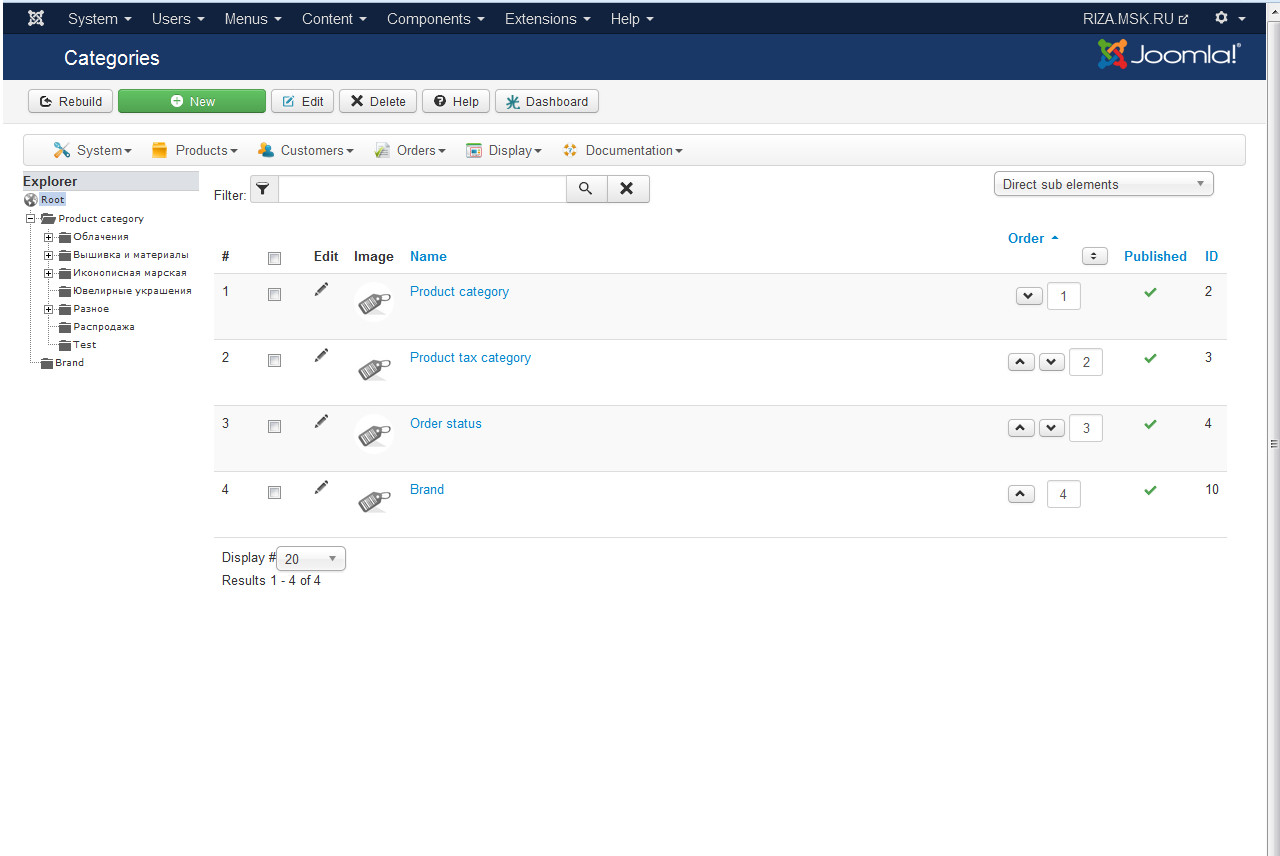

Hello
In the old version I had Root / Product category / Product tax category / Order status / Brand and now I can only see the Root / Product category / Brand.
Coming into the components/hikashop/category I see HTTP ERROR 505 with this link riza.msk.ru/administrator/index.php?opti...ry&filter_id=product , but if I remove prametr filter_id (product or number of id) I can see the Root like on image.

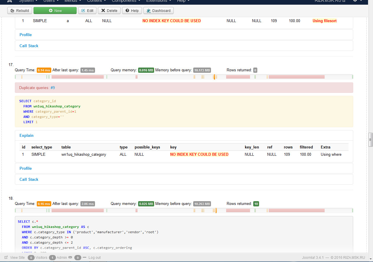

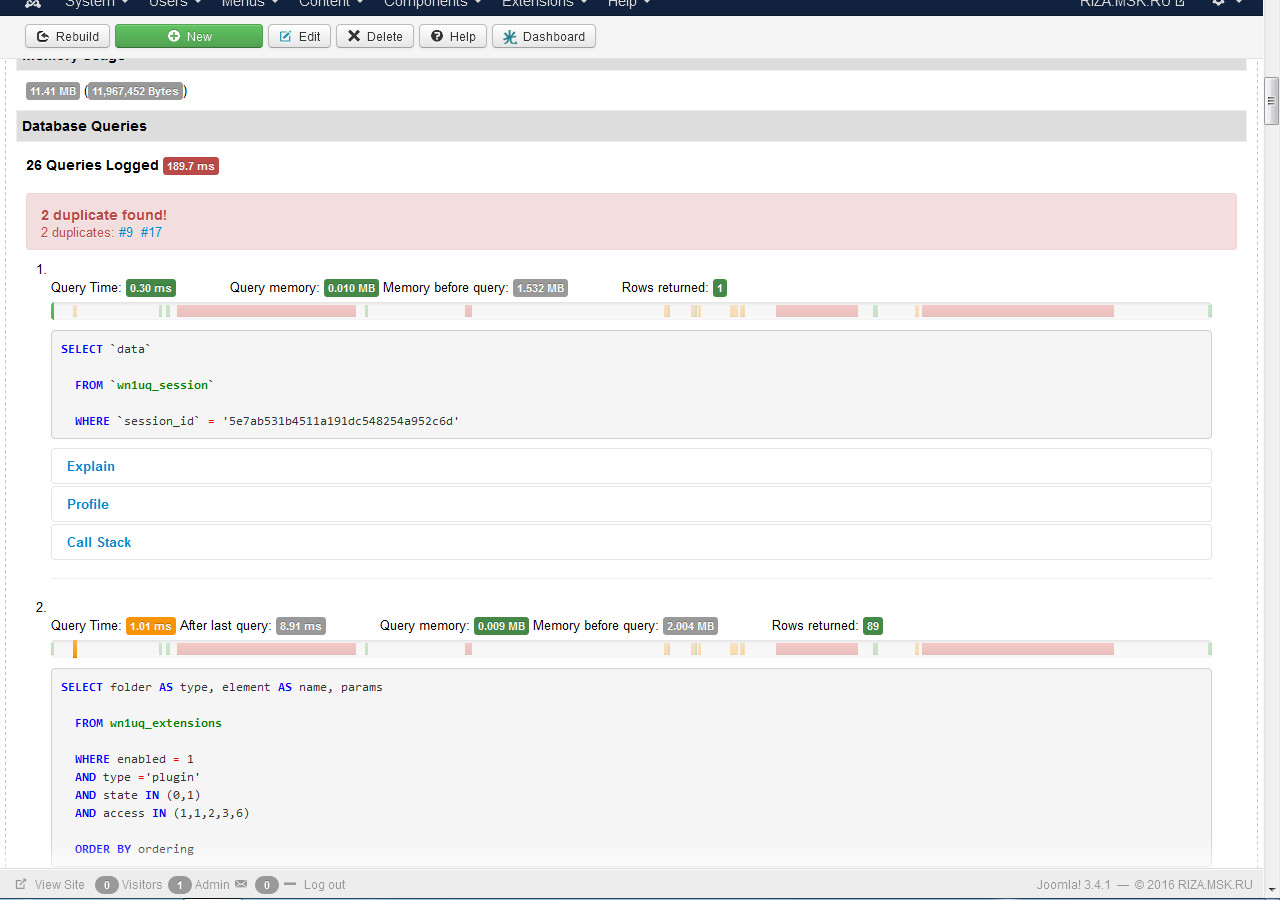

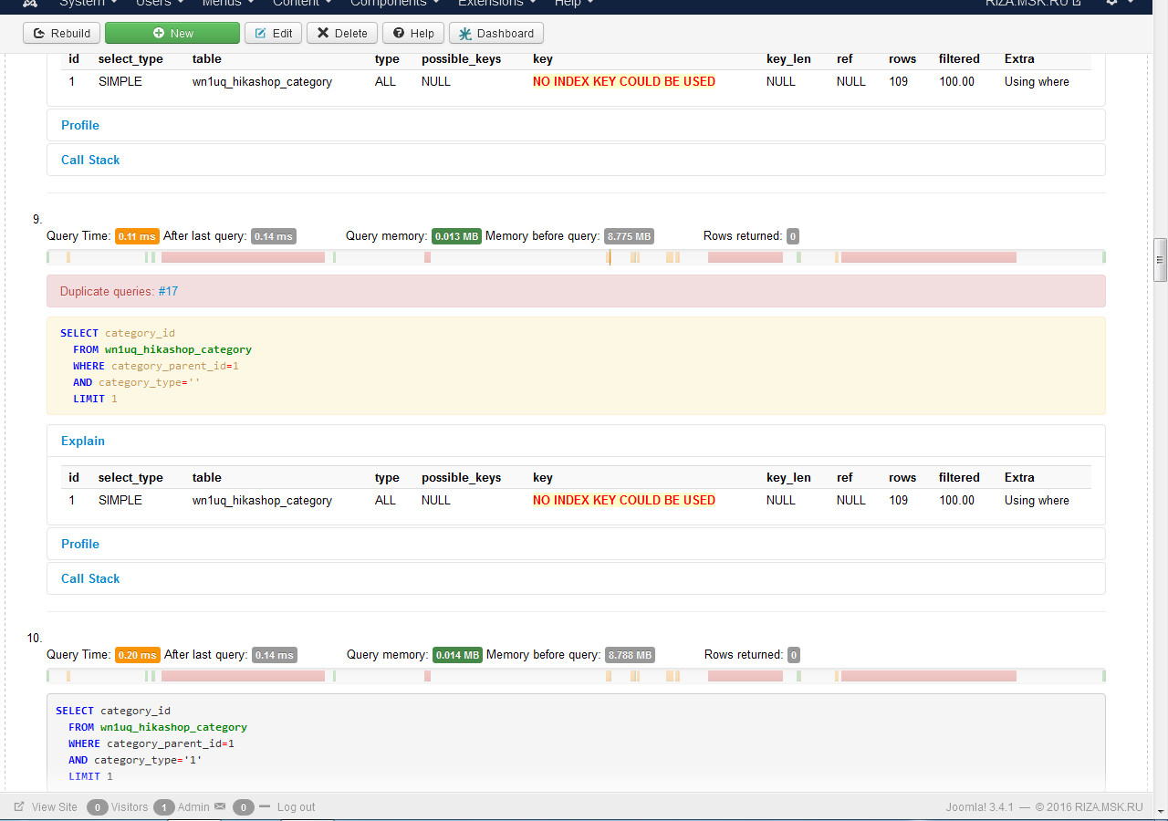

I do not know well I did or not, but I see such messages in the backend after activating debug and error.
  • Posts: 86081
  • Thank you received: 14192
9 years 8 months ago #258052
That debug data doesn't help.
I'm afraid you'll have to look at the PHP error log of your hosting for the PHP error message corresponding to the issue.
