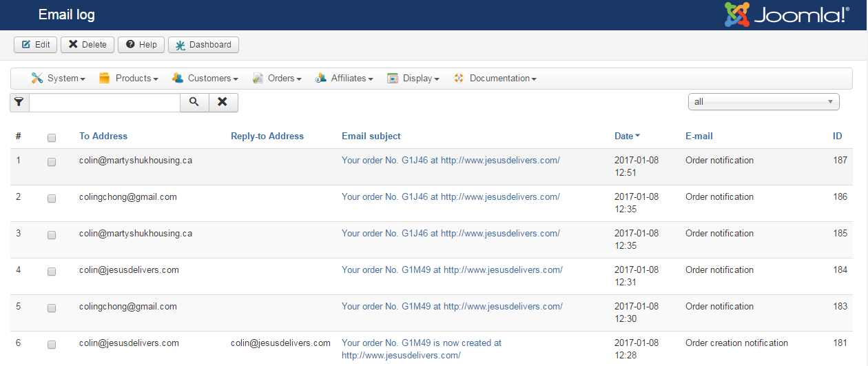

9 years 7 months ago #259187
What do you mean by " the log says it should have" ?
Which log says that ?
Are you maybe talking about the email server log ? It should contain the reason the email couldn't be sent, if the issue comes from the email server.
Do you see the email in the menu Customers>Emails history ?
Is its information correct there ?
Yes I did mean the Customers Email History. The emails do appear there and the information appears correct, see attached

  • Posts: 86081
  • Thank you received: 14192
9 years 7 months ago #259235
If you see the email in the Customer>Emails history area of HikaShop, it means that HikaShop correctly generated the email and then successfully sent it to the email server, and it's the email server which wasn't able to send the email.
First, check that you didn't get the email in your spam box.
Then, the next step is to check the email server log for more information about the sending of the email.
If you don't have access to your email server log (if you're on a shared hosting, you most likely don't) and even if you're on a dedicated server, it's probable you don't either), you'll have to ask your hosting company about that. Give then the information of one email that was sent by HikaShop but not received so that they can identify the email in their logs.
If you don't receive other emails from your website (like when you create a new account), it's probably something linked to the Emails settings in the Joomla configuration which have to be adapted to your email server.
If you do receive other emails from your website, it's probably something linked to the Emails settings in the HikaShop configuration which have to be adapted to your email server.
So you might want to also provide screenshot of all these settings when you contact your hosting company.
