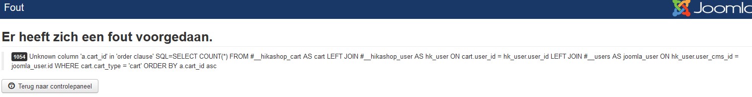

Furthermore tha carts overview is shown in a ascending instead of descending order. When you try to change the order by clicking on the collumn title of the "id" collumn an error is thrown.

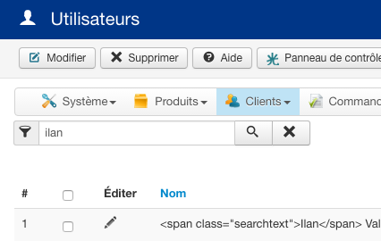

And I noticed that search results are not highlighted (searchbox customers). Instead html code is visible.

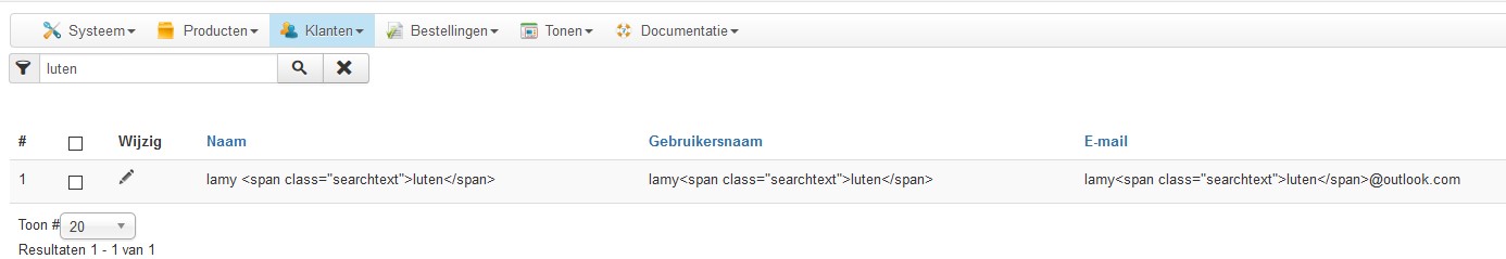

  • Posts: 70
  • Hikamarket Frontedition Hikashop Business
9 years 7 months ago #260275
Hello!
Same issue in client search result (see attached printscreen)
Thanks.
  • Posts: 86081
  • Thank you received: 14192
9 years 7 months ago #260279
I've added a new patch for that on our end. It should be good now.
