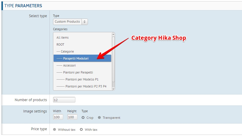

hi, use offlajn product slider for products carousel, my problem that when I click to go to the url product always containing the word component / hikashop / ...... I would like to eliminate it and replace it with the appropriate menu, I can you help? www.rtmetalli.it

  • Posts: 35
9 years 7 months ago #260296
the module takes the products directly from the category in Hika Shop, is not assigned to any menu, I am afraid that you have to put hand to the module.

9 years 7 months ago #260300
Then yes, you'll have to modify the module's code if there is no "menu" setting.
I would recommend to check with the developer of the module what they recommend.
