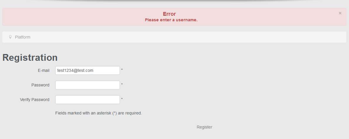

-- Error-message(debug-mod must be tuned on) -- : Error
Please enter a username.
Hi!
I'm using Simplified registration with password. When I'm trying to register, I see the error message - Error Please enter a username.
Where could be the reason?
9 years 7 months ago #260312
We updated the package this yesterday afternoon with a patch for that issue.
  • Posts: 61
9 years 7 months ago #260346
Thanks, that problem is solved now.

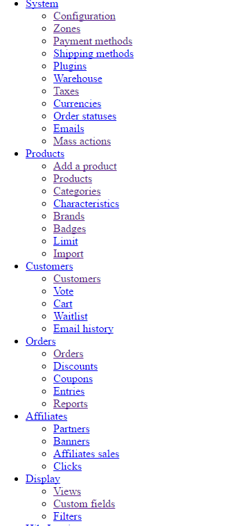

Just today updated Hikashop again, and now when I'm going to Products -> Products menu, I see
9 years 6 months ago #261868
It indicates that you have a PHP fatal error in the page.
As usual, please take a look at your PHP error log file in order to get the full error message and the corresponding file and line.
You can also set temporally the "error reporting level" to "maximum" in your Joomla global configuration in ordre to see the message directly in the web page.
