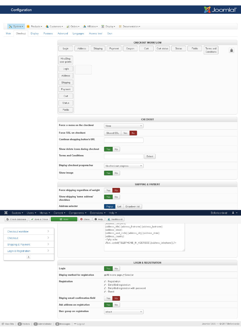

I'm using the login that appears in the checkout which I presume is the Hikashop login. (see www.bellaricordo.com.au ) the site is under construction and the only product is in the books category. The site has a single page checkout with "All in One Page" selected for login but the same happens when I use the selector.
9 years 7 months ago #260742

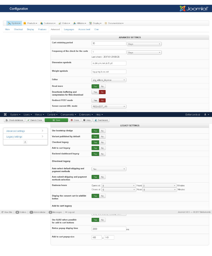

So please provide details about your current HikaShop configuration.
- Checkout > Login & registration
- Advanced > Legacy
  • Posts: 259
  • Thank you received: 22
9 years 7 months ago #260813
Hi Jerome, As requested, see attached

9 years 7 months ago #260849
Thanks. We were able to reproduce the problem and added another fix for it.
Please download again the install package on our website and install it on yours and it will add it.
