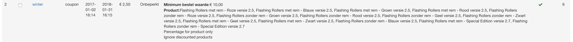

After the update to 3.0.0 the coupons no longer work.
Adding a coupon in the coupon to she shopping cart works but the discount is 0.
In the back-end the overview says the coupon is published but when you click the coupon all switches (including the published switch) are set to "no"
If you switch them to yes and save the coupon they are switched back to"no".
I hope you an help because customers are complaining that they cannot add the discount.
