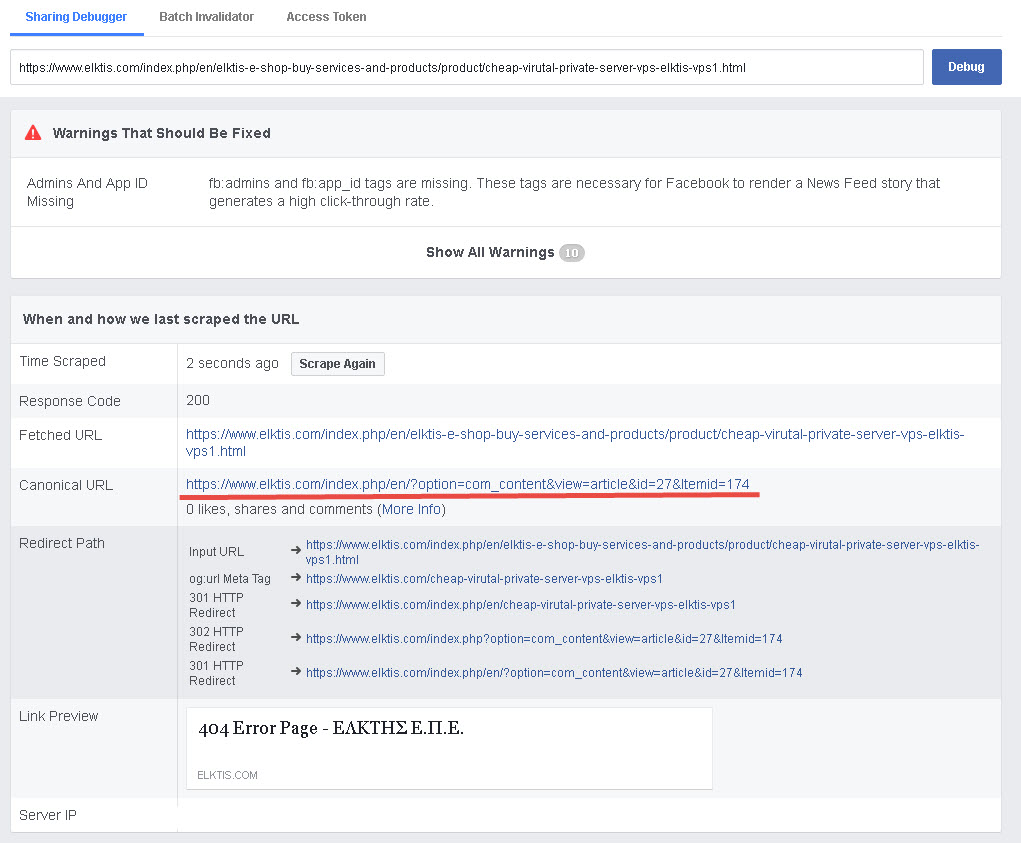

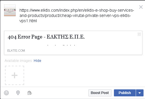

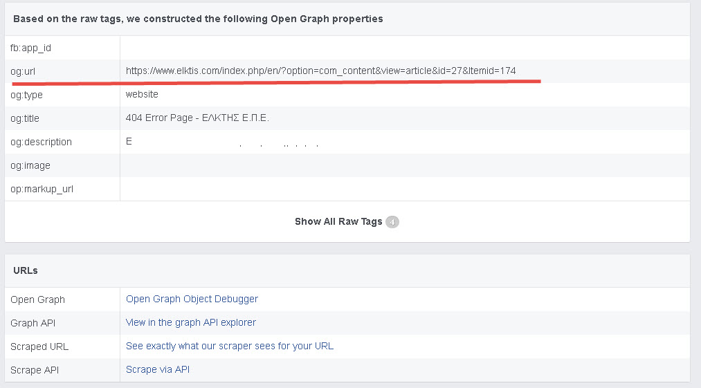

Yesterday, when i want to first post a product on facebook page, i saw a strange happened !
I saw that in facebook, no image or something that normally displays as you post a correct link normally, but facebook returns an 404 error.
As i hit the 404 error link i go correct to the page i post. No error. Error is only on the facebook link parser. I don't know why.
Check also this link:
www.elktis.com/index.php/en/elktis-e-sho...vps-elktis-vps1.html
this is a link of one product.
So in facebook, displays the problem 404 page.
and also in the scrapper i fount this.

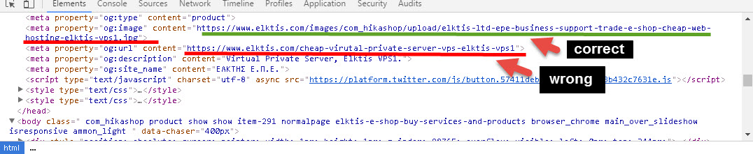

Also, i cannot find this erroreus canonical url and also i cannot delete the canonical urs.
I don't know why.

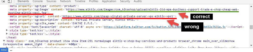

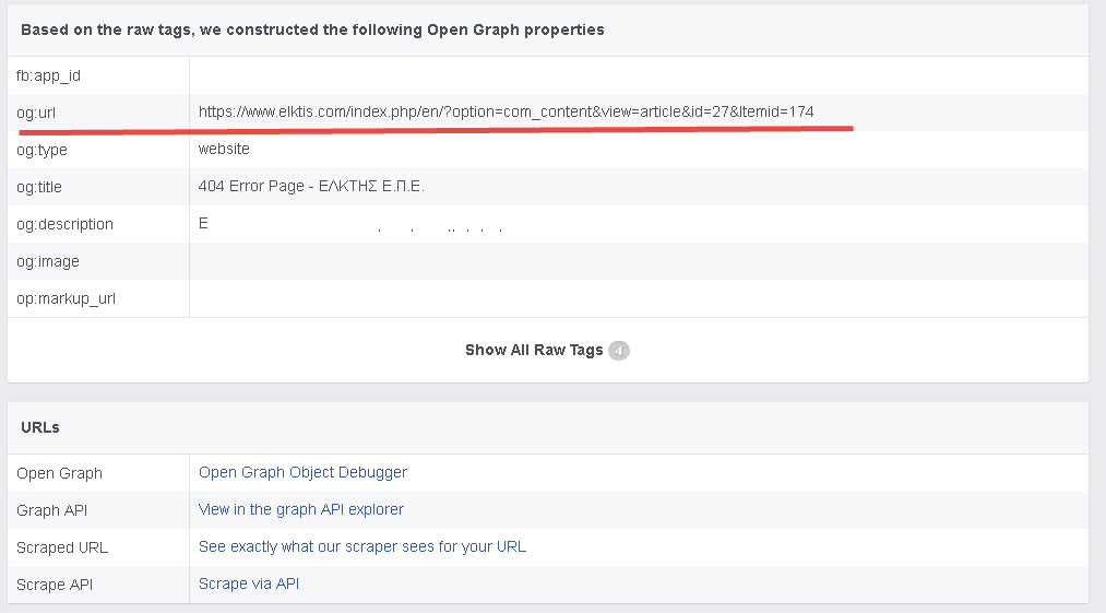

Also , as i check i see here the wrong line..
but i don't know how to correct it
all the facebook details are correct , except the og url.
  • Posts: 14
9 years 7 months ago #260786
FINALLY,
If you delete the "canonical URL" field, facebook scraper working correct .
THE MAIN PROBLEM IS THAT YOU CANNOT DELETE THE "CANONICAL URL" FIELD, ONLY TO EDIT !!!
THIS HAS TO DO ONLY WITH FALANG. FALANG SHOULD MAKE A CORRECTION UPDATE.
WE CAN DELETE IT ONLY THROUGH SQL.
SO PROBLEM SOLVED !

9 years 2 months ago #270963
If you take a look at the post #260740 you will see a screenshot showing the issue regarding correct and wrong link.
Please understand that you did not provide any information related to your website, your configuration, the version number you're using, the URLs.... So we cannot provide you a effective support help if we don't know anything about your issue.
