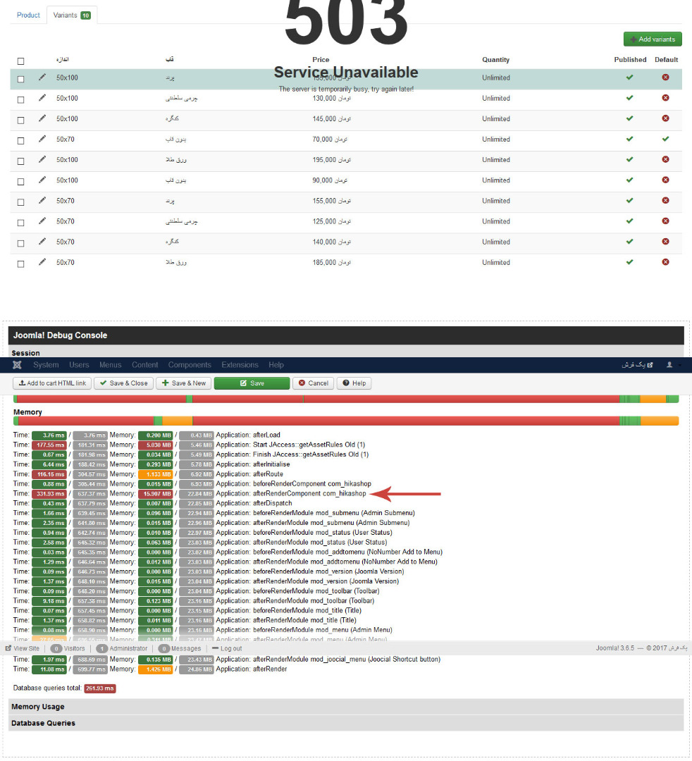

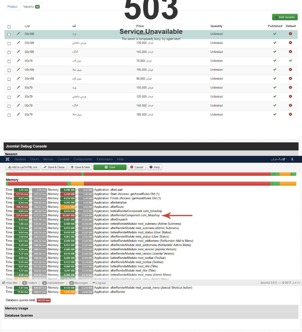

When i updating from 2.6.4 to 3 version when save the Variant getting the attached error.
503
Service Unavailable
The server is temporarily busy, try again later
503
Service Unavailable

9 years 9 months ago #261371
by sahab666
Replied by sahab666 on topic 503 Service Unavailable error in save the Variant
error attached
9 years 9 months ago #261372
by Jerome
Replied by Jerome on topic 503 Service Unavailable error in save the Variant
I am sorry but it does not indicate an error.
We just see that a page is processing by HikaShop but nothing is showing that there is an error or a problem.
So there is no related "error message" to that 503 page.
Please check your PHP error log.
