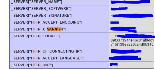

I'm not sure if we have varnish. See the attached screenshot. Any thoughts?

Your screenshot www.hikashop.com/media/kunena/attachments/48086/varnish.JPG seems to indicate that you do have Varnish on your hosting.
Which is why I recommended to either deactivate it or install the integration with Joomla in order to prevent that problem.
The problem could have happened suddenly if Varnish was added by your hosting.

Thank you Nicolas. Turning off Varnish did the trick! I appreciate your expertise and great help. Thank you again!
