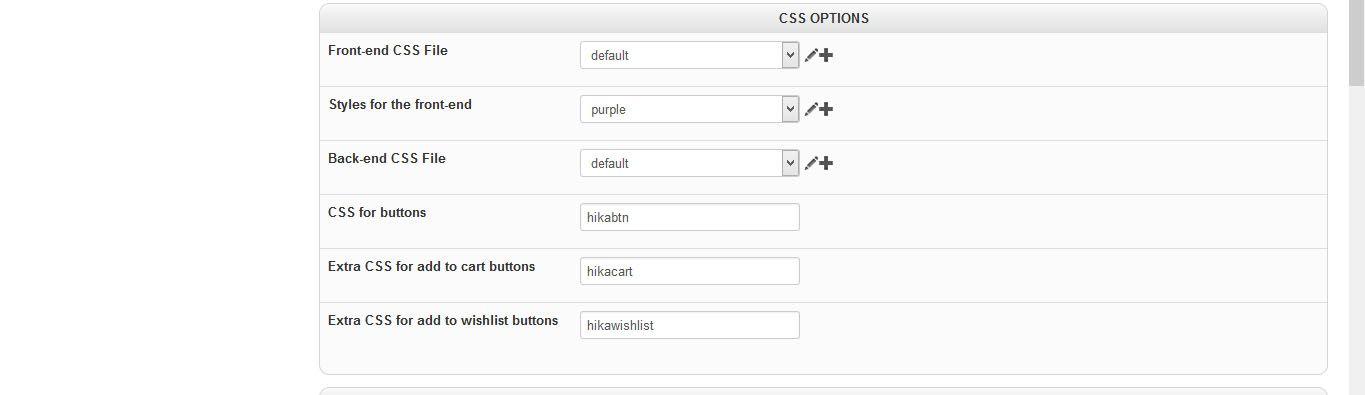

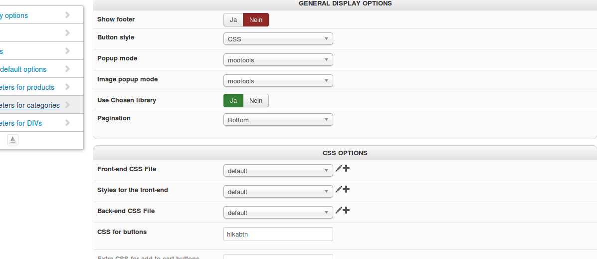

  • Posts: 31
9 years 5 months ago #263977
Hi again,
did some testing and modifying. But I still can't solve some issues.
Pls, advice where to look.

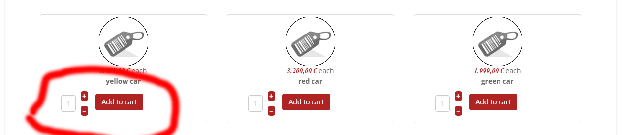

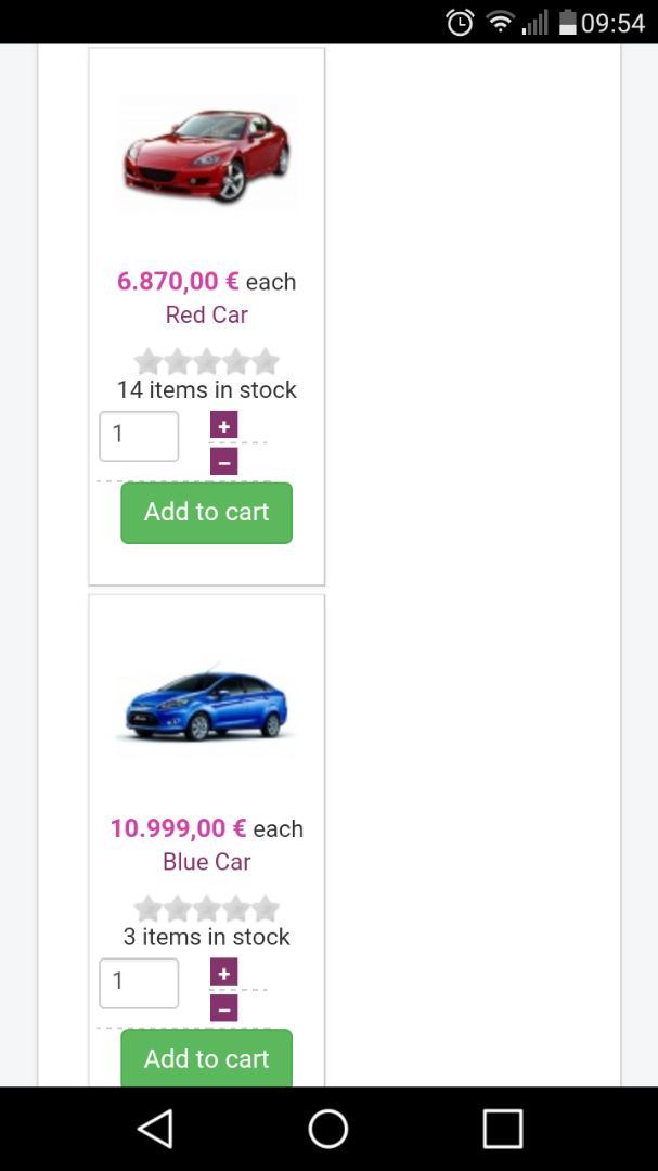

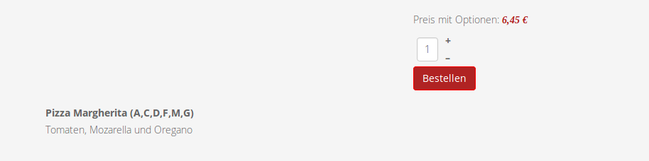

In pic1 I can't get the quantity field and the order button in the middle and centered. I went the style_default and frontend_default up and down. Tried different things, without luck.

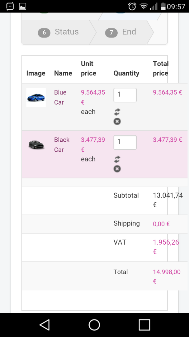

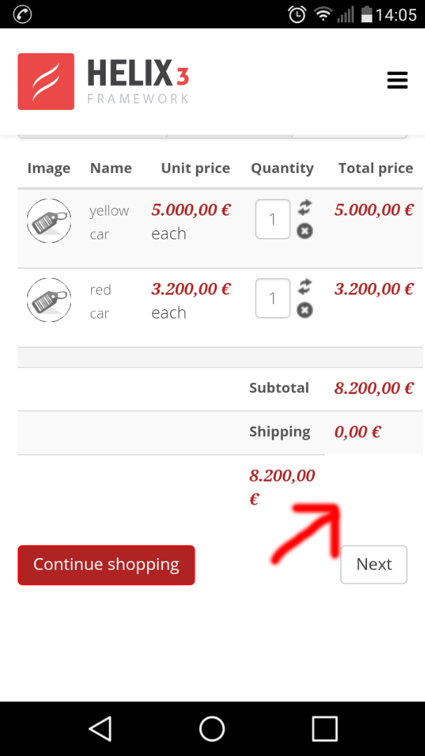

In pic2 there is a hell of space under the product pic, then @ the end of the page the title and description
are placed, the price as seen in pic3, is on top of the next column on the right.
In pic4 I don't get the bottom buttons on checkout, so I am stuck in the cart

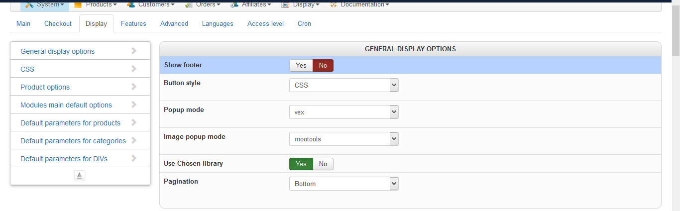

In pic5 I attached to display config of hikashop

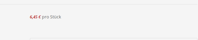

One last thing. I can't get the prices be shown with vat. Hikashop is ignoring my configuration. When I configure with tax or without tax its always the price without tax. Even when I configure price both. I get shown both prices with out tax. And yes, tax class is configured and used in product. As well is there a price with and without tax.

  • Posts: 86081
  • Thank you received: 14192
9 years 5 months ago #263986
1. to 4. and 6. We can't say. Please provide a link to the page so that we can look at the situation and analyze the CSS on the page.
5. The taxes issue is something we've fixed since then.
Download again the install package on our website and install it on yours and that will fix the problem.

1. You can do that by adding such CSS:
.hikashop_listing_img_title form{
display: inline-block !important;
width: 50% !important;
.hikashop_listing_img_title form table, .hikashop_listing_img_title form .hikabtn{
float:left;
2. and 3. The page is separated in 4 areas:
- top at the top iwith the name
- left with the image
- right with the price, options, add to cart
- bottom with the description
If you want to change the order of the elements or change them from one area to another, you can edit the file "show_default" via the menu Display>Views. More information is available here:

6. Normally, even if you turn off the display of all the taxes, you should still see the total tax amount after the shipping and before the final total on the checkout cart.
Since you don't get it, it means that no tax is applied because HikaShop couldn't find any tax rule matching with the product tax category and the main tax zone you configured in your HikaShop configuration.
So the problem is with the way you configured your tax rules I suppose. I would recommend to check this FAQ in order to see what is the cause of the situation:
www.hikashop.com/support/documentation/3...ion-listing.html#faq

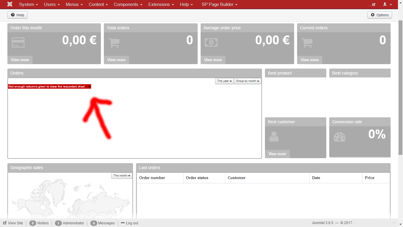

have 2 further problems:

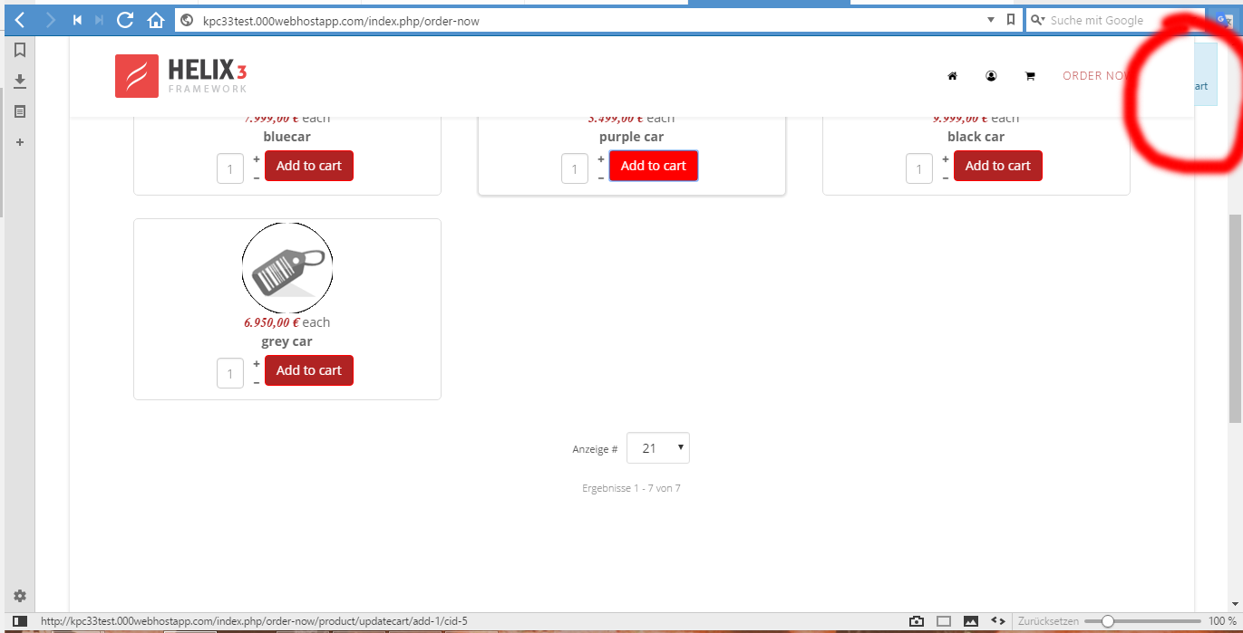

the add to cart pop up is behind sticky header of helix 3 template, can this be fixed
I get an error in the dasboard, pls see attached pics
  • Posts: 86081
9 years 5 months ago #266055
1. I tried on my end but I do see it on top:
monosnap.com/file/Hph8nyFLzDh48Z0NUIfqytUVWBfVqC
2. That's normal. As the message says there is not enough data to display anything.
And if you look at the orders listing below you can see that there are no orders in your shop.
And it's impossible to display a chart of the orders over time without any orders placed.
  • Posts: 31
9 years 5 months ago #266084
@1: For me it's only working on Chrome 57 and IE 11 aswell as on Android 6 with their Internet Browser 5.70 and chrome 52
Won't work for me with Vivaldi 1.7, Firefox 52 and SlimJet 13
With this browsers it's only working as long as you don't scroll down. The moment you scroll down and the header with the nav bar get's to fixed, the pop up will only show up behind the header
@2: thx for the explanation. I was irritated of the error message due "Not enough columns given ....". I was thinking of there is not enough space.

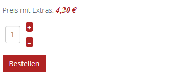

regarding your post of yesteday, 1) the code is working, but I still have an formating issue as shown in the attached pic. I was playing with the % but that's my best result

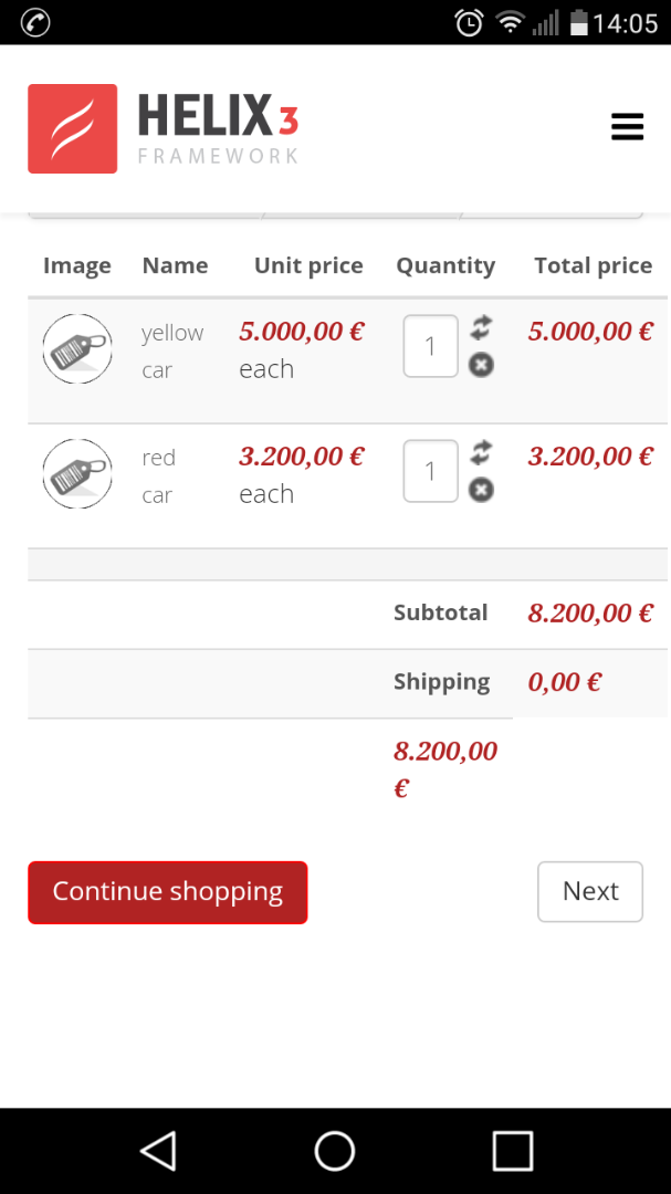

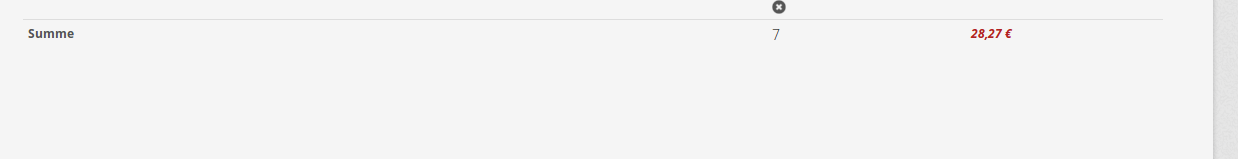

  • Posts: 31
9 years 5 months ago #266087
Hi again,
I became aware of 2 further issues.
See attached pics.
Where to fix?
  • Posts: 86081
9 years 5 months ago #266089
1. Thanks for the additional information. This comes from your template though. I was able to reproduce the problem and added a patch in order to fix the problem so that the problem shouldn't happen anymore. Download the install package and on our website and install it again and you'll get the patch.
2. You could add such CSS:
a.hikacart {
margin-top: 3px;
On my end it then displays properly: monosnap.com/file/lou4NoCzpUGDnMb7rHPidIE2Jnu9vq
3. For the input fields that's also linked to your template CSS.
Add such CSS to prevent that:
.hkform-control {
width: auto !important;
4. That comes from the code:
#hikashop_checkout_cart_final_total_title {display:none;}
of the file /media/com_hikashop/css/style_les.css
Remove it and it will display properly.

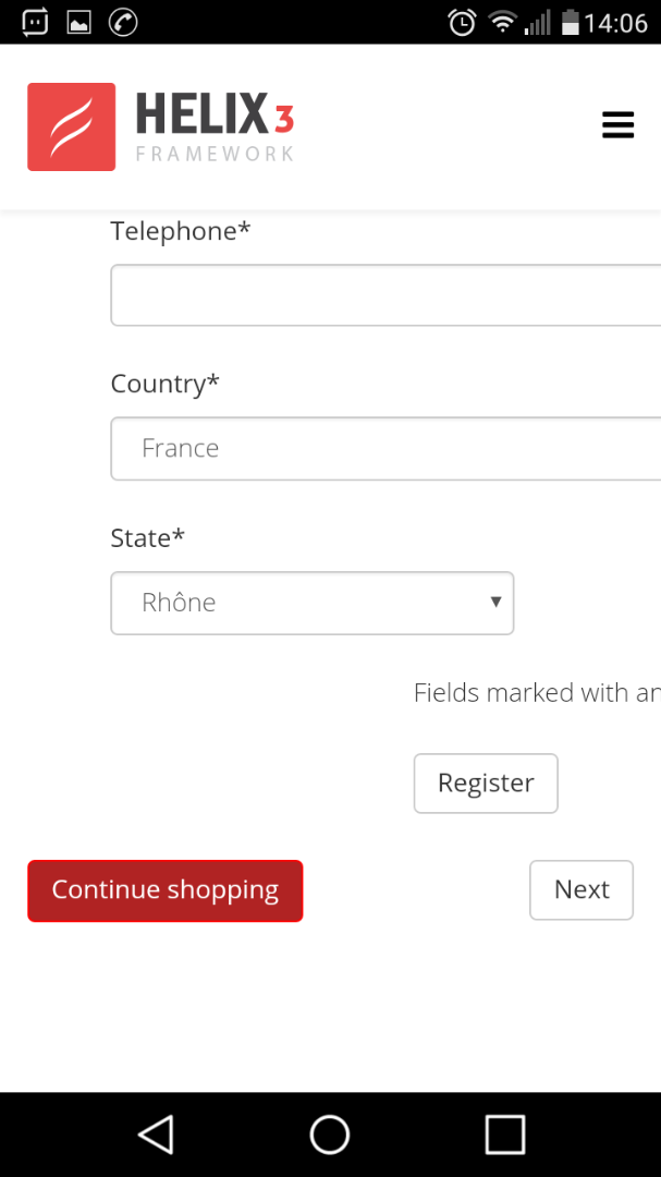

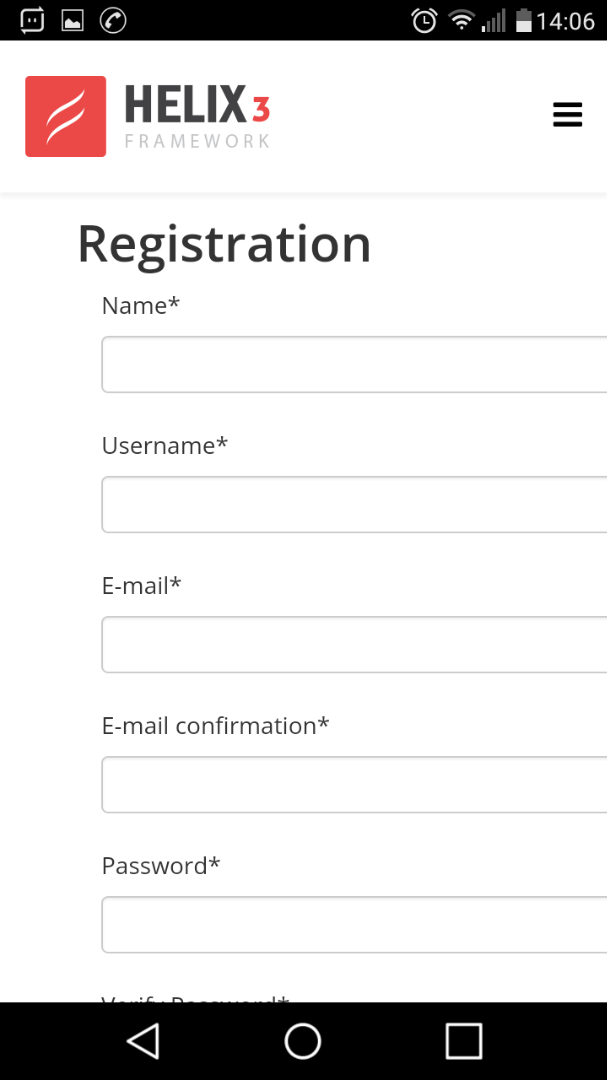

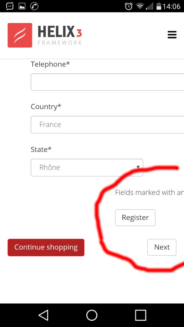

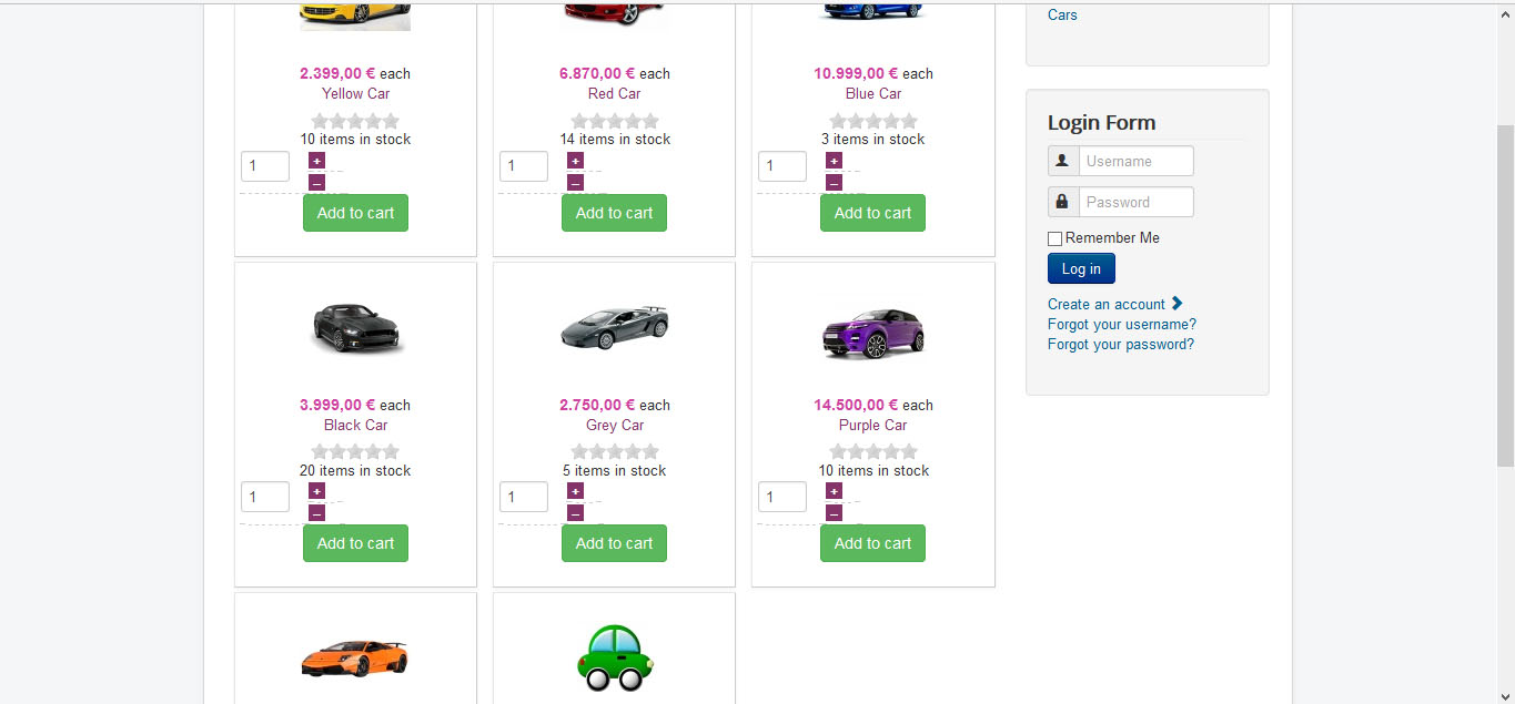

9 years 5 months ago #266215
Is this new? That there is a next button on register and login?
Where can I center the whole add to cart and quantity field al marked?
9 years 5 months ago #266173
1. Hikashop actually use the Joomla Email system.
2. In checkout legacy, the "next" button could be hidden.
3. www.hikashop.com/support/documentation/1...the-display.html#css
Last edit: 9 years 5 months ago by Jerome.
  • Posts: 31
9 years 5 months ago #266272
2. have disabled "Checkout"," Add to cart", "Backend dashboard" legacy at setup. So therefore legacy shouldn't be a concern.
When enabling legacy mode I can't find an option to hide "next" button
9 years 5 months ago #266277
It will actually depends on how you configured your checkout workflow via "Hikashop->System->Configuration->Checkout". So to be sure that you won't have any "next" button, you should make sure that your checkout workflow will have only one step.

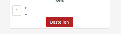

I found another issue.
When you go to a product page.
1) The hikashop_product_options and hikashop_product_characteristics in the product > show_default view will always exceed the screen of my phone.
Even with " with: auto !important" they won't stay on the screen
2) the "add to cart" button will always go to the next line, see attached pic
Advice pls.
Last edit: 9 years 4 months ago by Jim. Reason: forgott to attach file
9 years 4 months ago #266424
For your display issue, I think you can use Css order, @media, like this :
.your_element_to_modify {
     width : 600 px;
@media screen and (min-width: 480px) {
         width : 200 px;
Here, that means that your element will be 600px for all screen except when screen size will be under 480px, that will switch to 200px.
