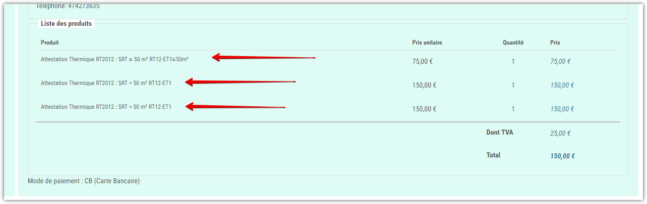

I have Truncated the Hikashop_order table via MyPhpAdmin in order to start from 1 the order numbers and the invoices.
Have put into order an article for 150 € TTC
Made the test payment via CMCIC without any problem and for the right amount.
But when I have a look at the registered order I come uo with a different number of items in that order...
What am I doing wrong ?
Best regards
Stéphane

That's because you truncated the hikashop_order table but not the hikashop_order_product table.
So you get the products from the order with the same id that you had before.
You should truncate both tables.
Truncate also the hikashop_history table which contains the history of the orders.

Thank you so much !
I didn't know that I should also truncate the 2 other tables...
I will do so.
