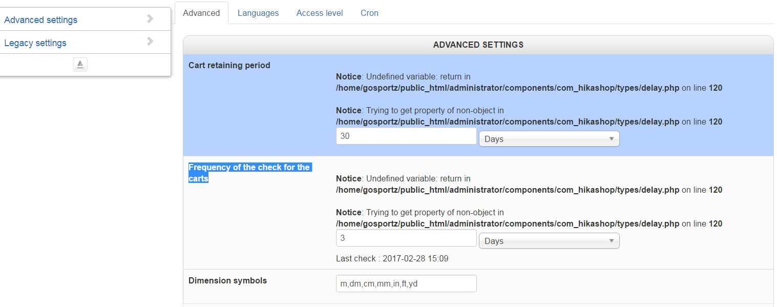

-- HikaShop version -- : HikaShop Business (3.0)
-- Joomla version -- : 3.6.4
when i go to hikashop configuration, i noticed there is error written as below at Cart retaining period and Frequency of the check for the carts
Notice: Undefined variable:
return in /home/mysite/public_html/administrator/components/com_hikashop/types/delay.php on line 120
How can i fix this ?

we saw this same error for a couple of days last week, but downloading and installing the latest Hikashop 3 build fixed it for us.
The Hikashop team is still adding fixes and improving Hikashop 3, and even though it's still called version 3.0.0, there are improvements almost every day so if you encounter any problems you can first always try downloading the most recent build version to see if the problem has already been fixed.
Hope that helps.

We actually already fixed it, so you should download the last Hikashop version through our website, install it and test it again.
Also, Notice messages won't affect your shop.
Note that when your shop is in production mode you should :
- Disable the Joomla debug mode ("Administration->Global configuration->System->Debug System/Language")
- Set the "error reporting" option of the Joomla configuration to "none"
