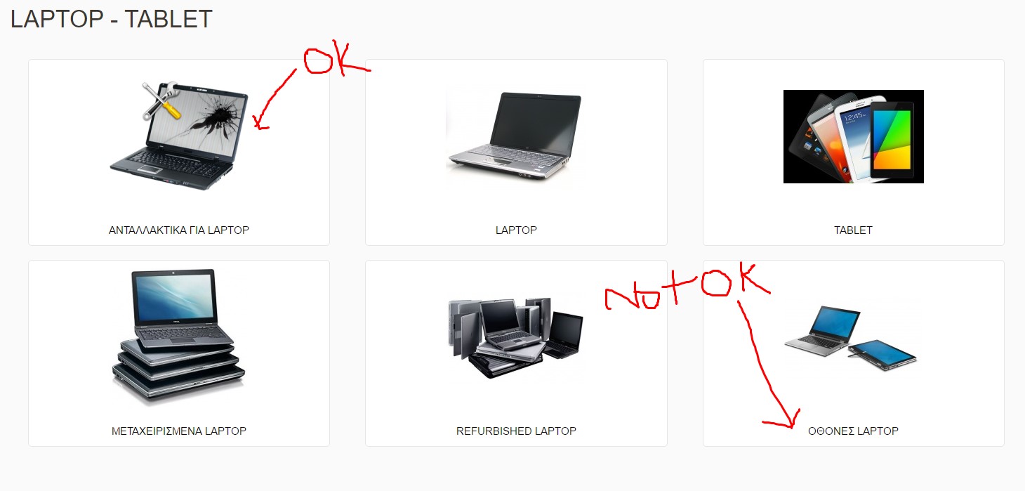

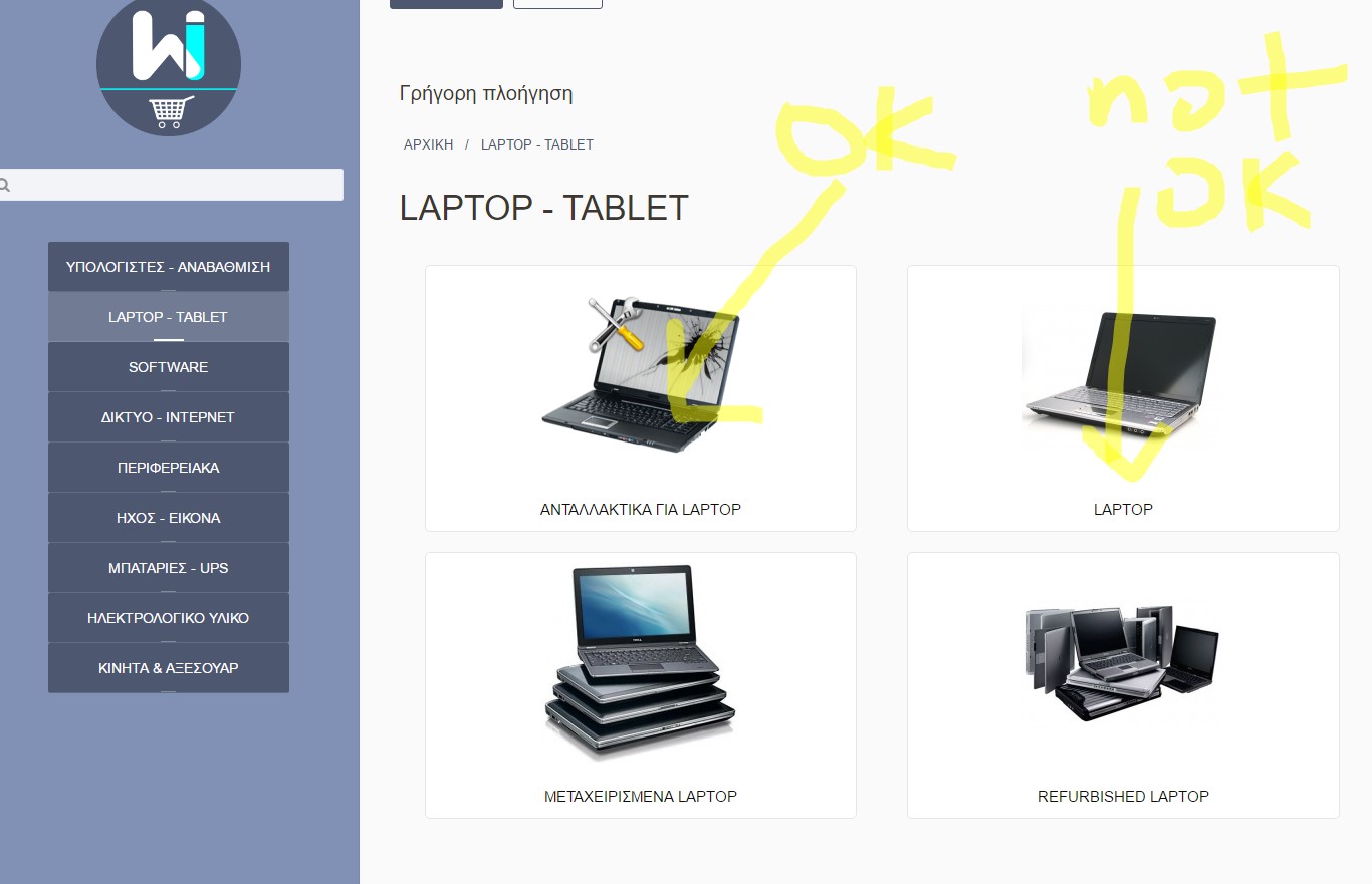

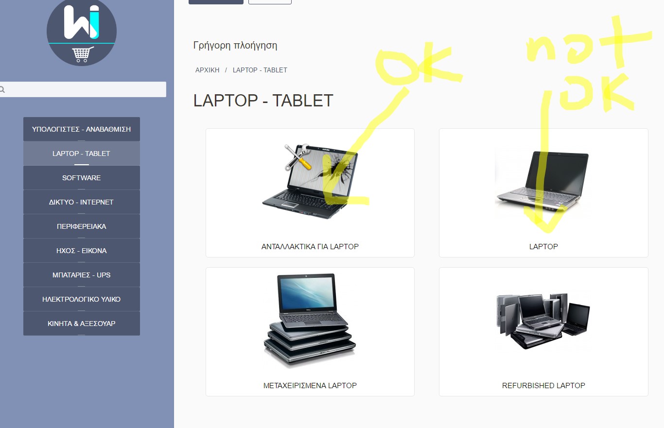

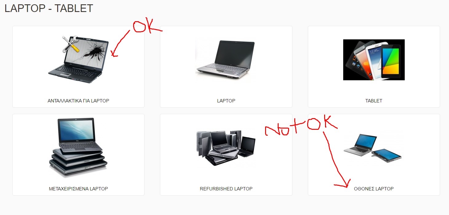

I m trying to understand why in two different menus with the exact same configuration (menu settings, and hika category settings) I have differnt url. Some of my urls when I click on a hikashop category have ids inside, and others have a clean url , the same with the Joomla menu.
I cleared cache, deleted all canonical urls everywhere, I even emptied some tables that could probably cause issues but no chance.
What am I missing here.

If two categories on a same listing have a different URL structure, it's either:
- the canonical URLs that are wrong
- the page that is cached
- the SEF URLs that are cached (if you have sh404SEF for example)
I don't see any other reason.
