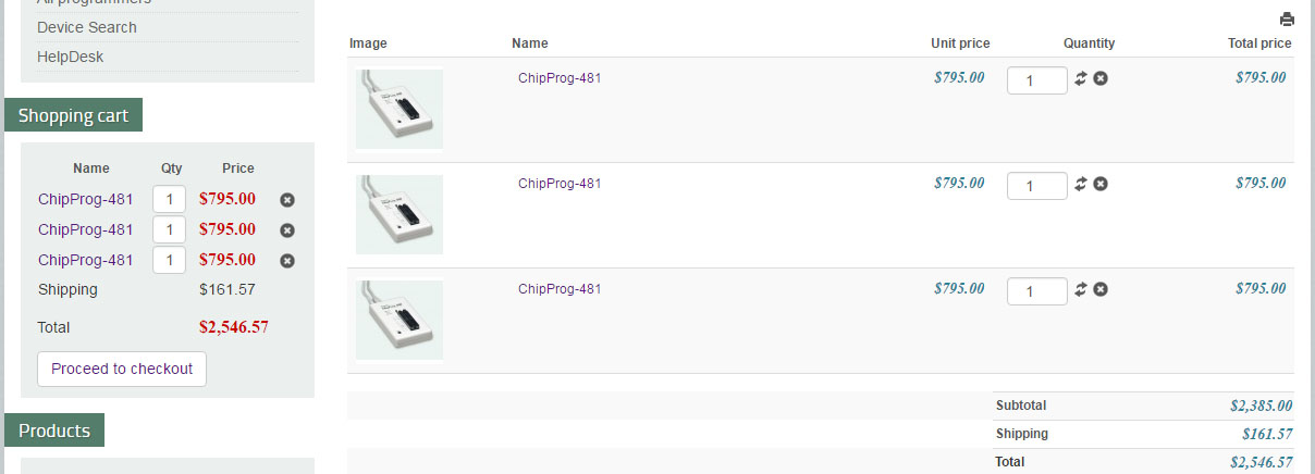

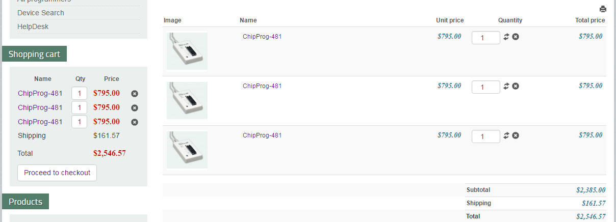

1) When I use "hide if empty" option in cart module, cart content isn't shown, but the module's title remains. In hikashop v2 the title was hidden too.
2) When adding the same product several times, they come into the shopping cart as separate products instead of product quantity being updated (it also worked in v2). It looks weird, see the pic 1.
3) For some reason adding a product to cart is taking ridiculously much time in both normal and legacy modes. Now, after pressing "add to cart" button, nothing happens for 5-7 seconds. I restored hikashop v2.6 and checked again - it takes for sure less than a second to add a product to the cart.
Thank you in advance!

1. Yes. We had to change that since otherwise, the cart module cannot be refreshed by the AJAX process when a product is added to the cart and that the cart is empty. However, regarding the title, you can turn off the display of the title of the module. And if you want to display it only when the module has content, then you can add it in the file "cart" of the view "product".
2. & 3. We don't have that on our end. Is it for all the products ? Could you provide a link to a page where we can look at the issue ?

Thank you for the new account access. It worked now. I was actually able to find that the issue came from the custom item fields you have. The custom text custom fields were not handled properly in the new cart and thus, the system was thinking that the product added to the cart had different custom item fields than the one already in the cart for these custom fields.
I've added a patch on our end for that. Download the install package on our website and install it on yours and that will add the patch for it.
