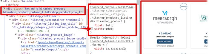

After updating to the newest hikashop version. The modifications in the views are not working anymore they are still there but it seems the hikashop version does not respond to that. Also the listing of the products are not as we put it how we want it..
please take a look for us. hieruwuitvaart.incunopra.nl/producten-di...n/uitvaart-pakketten this is how we want it after the update it looks like this. hierutest.incunopra.nl/producten-diensten/uitvaart-pakketten

For your first point, lots of things have change with HikaShop 3.x, and if you speak about override view (or custom view) that's not really a surprise if you have some modifications in order to fit new structure.
For your second point, with the help of your 2 links it's seems that the issue come from your custom frontend css, remove your width order on your listing class, see by yourself :
Hope this will help you.
