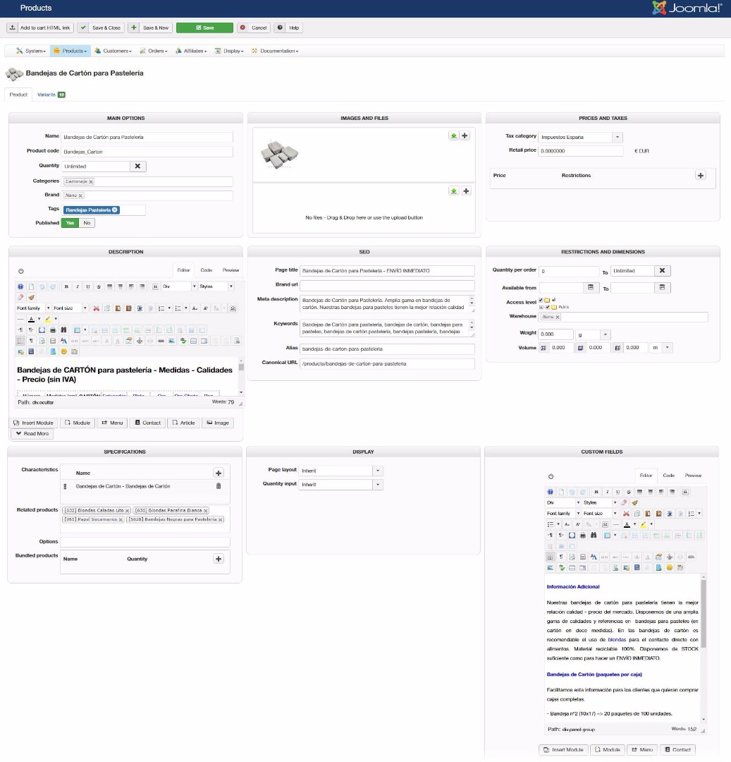

  • Posts: 460
  • Thank you received: 19
9 years 4 months ago #269681
Hi.
Error when saving the product to have a custom field of type WYSIWYG, I send you image of the product and code that we want to add and when we want to save gives us error 500
  • Posts: 86212
  • Thank you received: 14219
9 years 4 months ago #269741
We don't have any error when saving that HTML in a custom field of the type "WYSIWYG" on our end.
You can try on our demo website if you want to make sure.
As I said, it must come from a content plugin you have on your website. Try deactivating them one by one in order to see which one is causing the problem.
  • Posts: 460
9 years 4 months ago #269748
Hi.
The error has been solved this morning when joomla is upgraded to 3.7.1
Thank you very much.
