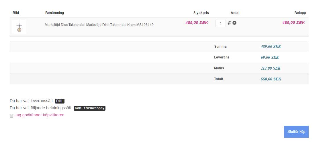

Hello

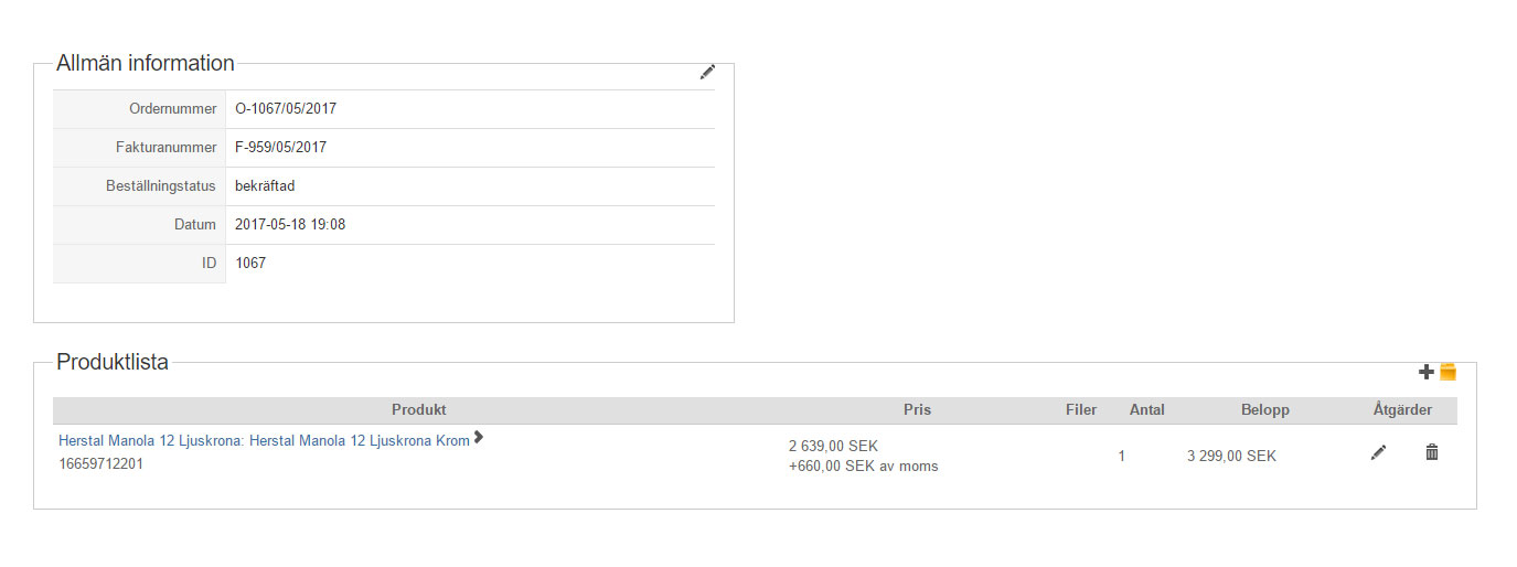

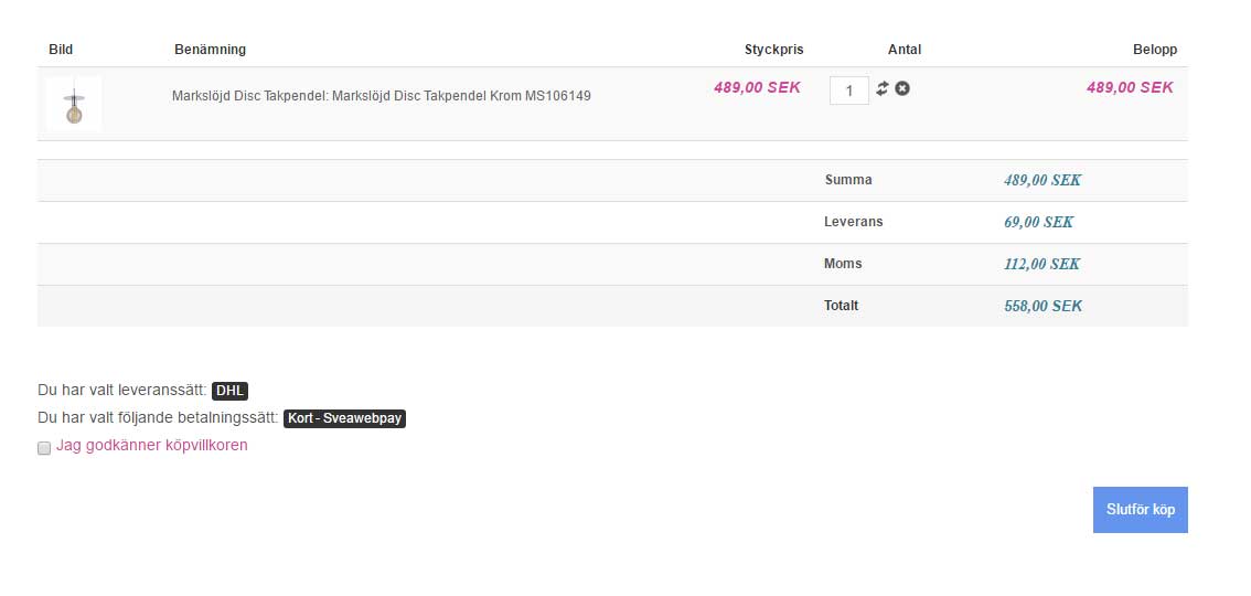

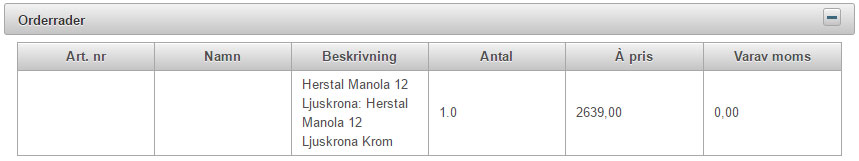

After updating to 3.0.1, the VAT for the products will not be sent to Svea, it will be displayed correctly with VAT at checkout and backend in hikashop, but not at Svea webpay.
Has anything been changed, any setting you need to do after the update?

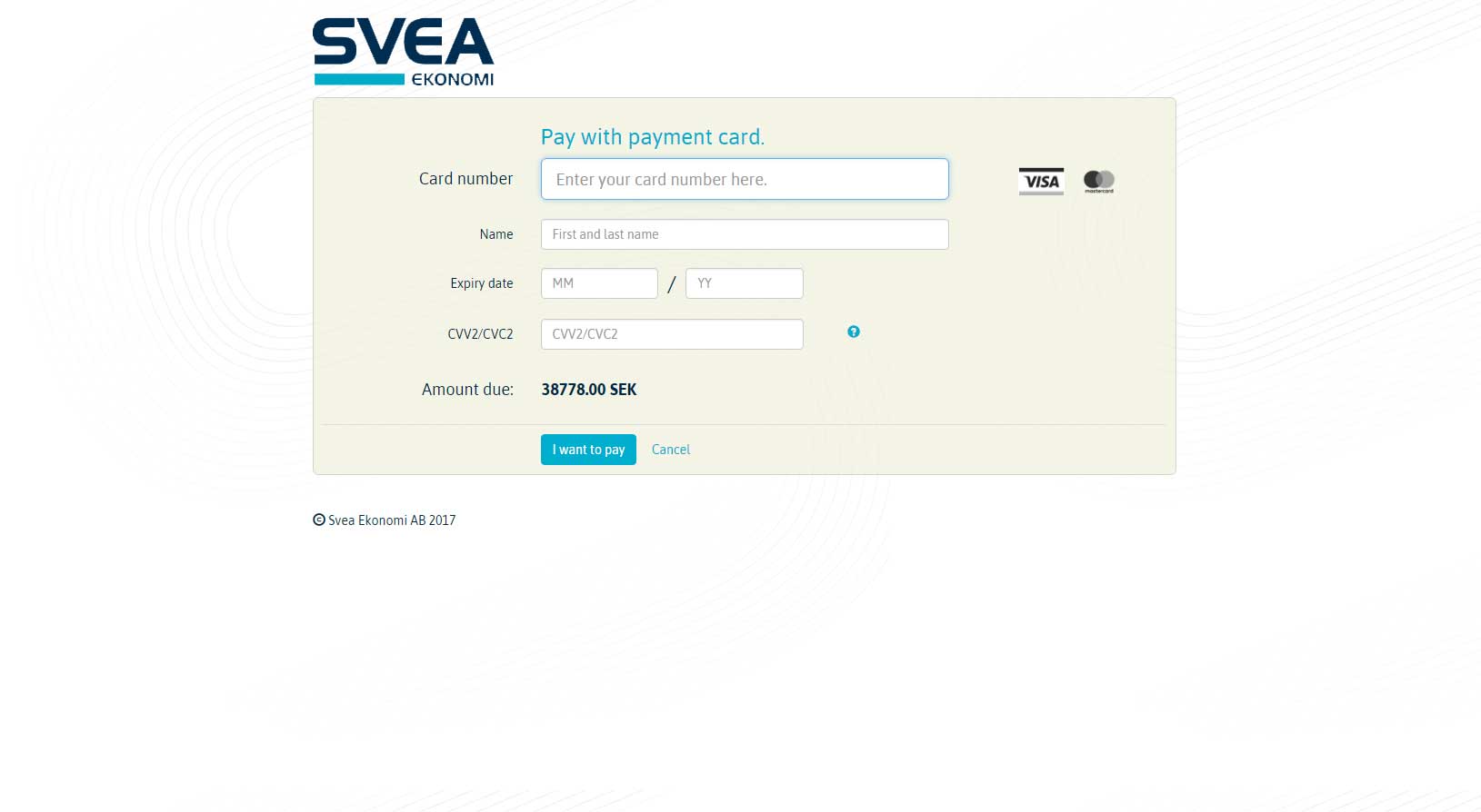

  • Posts: 29
9 years 3 months ago #269943
Hi Nicolas

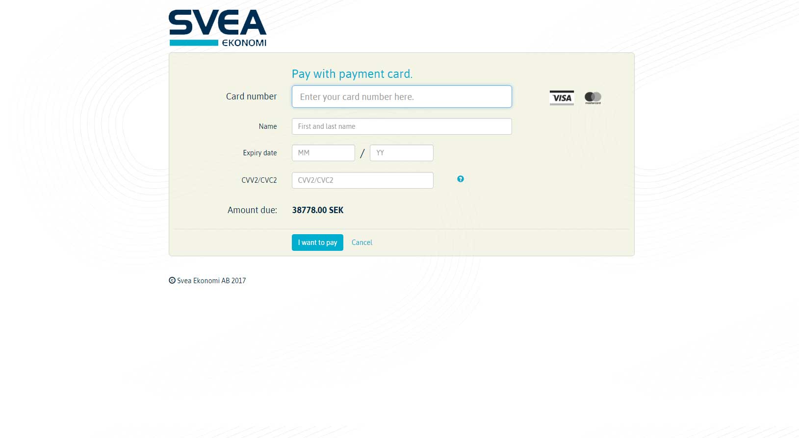

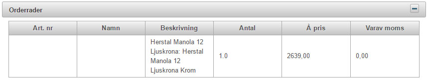

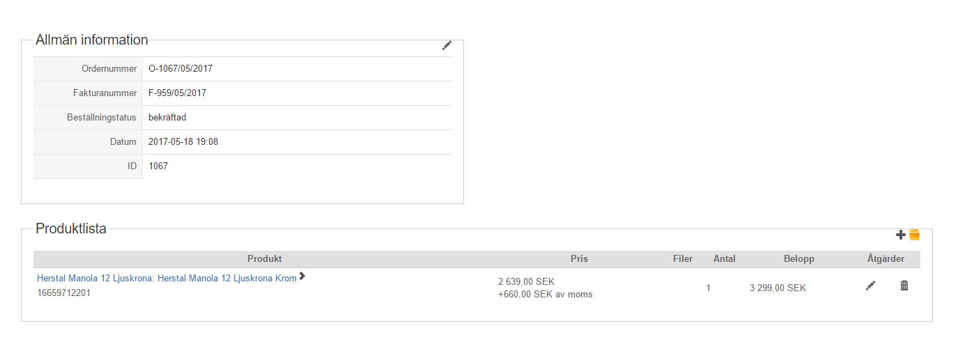

I have now tried to replace the code but unfortunately did not work.
As you can see in the pictures, the sum sent to Svea is now much larger than the order value.
Henrik

Ok. I see the problem.
Then please replace that code by:
if(isset($product->order_product_tax_info)) {
				$tax = reset($product->order_product_tax_info);
				if($tax->tax_rate > 0)
					$product_tax = 100 * $tax->tax_rate;
That should be much better.
