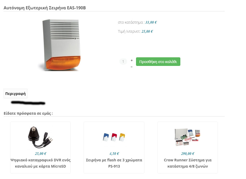

Once I made the upgrade to joomla 3.7.1, the description on the products stopped appearing. See the following example.

The link was missing from your post. Could you provide it ? Could you also provide a screenshot of how the product is configured ?

9 years 3 months ago #270291
If you look at your browser console you will see
Uncaught ReferenceError: ExtStore is not defined
That JS error is not related to HikaShop ; but it generate an error in javascript so all the rest of the JS of the page is not processed, including the HikaShop javascript for the tabs.
You need to fix that JS error in order to let HikaShop Javascript to be executed by the browser.

The problem with the hikashop description was solved. Thank you very much.
