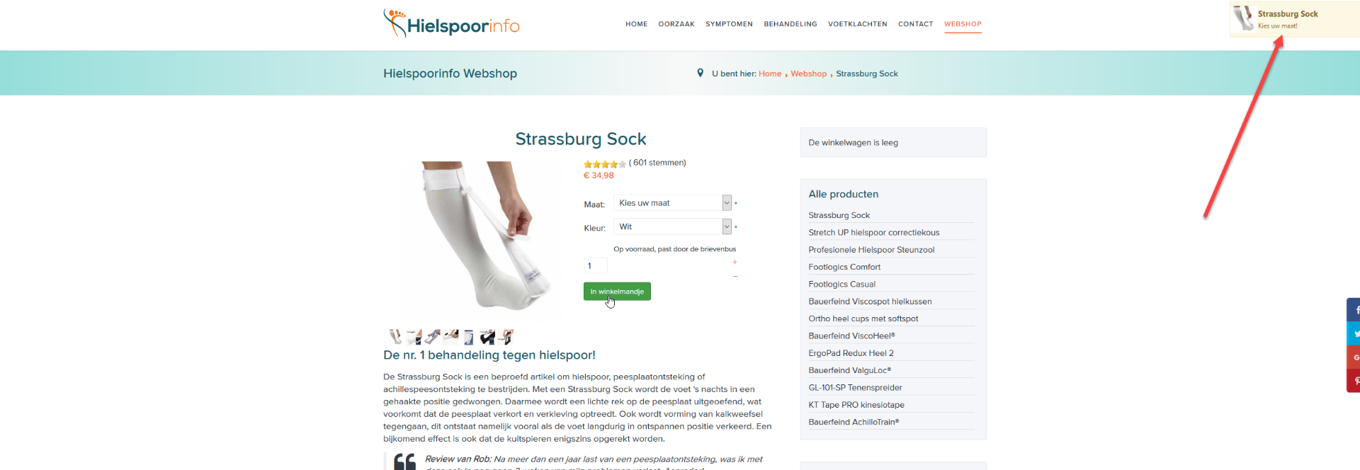

Just one thing that users might miss: I am working on a pretty wide screen now and the notifications in the upper-right corner coulkd easily be missed. Especially showing errormessages should really be more obvious I think. See attached the screenprint of an action where the user needs to select a size for the product. I really think users could miss this:
I checked the configuration for options to configure how errormessages are displayed, but I could not find any.
9 years 3 months ago #270576
That display is made by a plugin (HikaShop / Cartnotify) ; you need to configure it in the Joomla plugin manager in order to change the position or use the "popup" mode.
In the future, more notification plugin might be available.
www.hikashop.com/home/blog/367-hikashop-3-0-out.html

9 years 3 months ago #270640
Ok, thanks for clarifying, pop-up mode works fine for me. Thanks for clarifying, all set to upgrade now ;)
