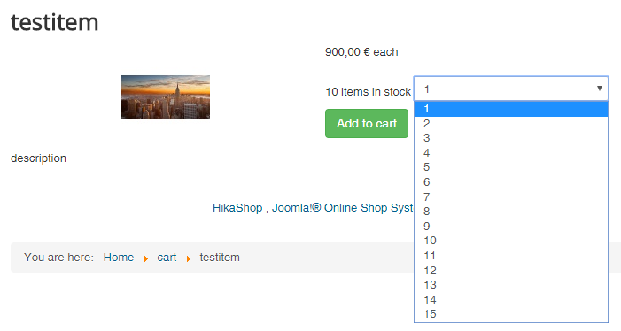

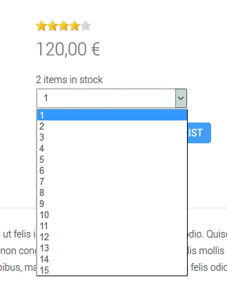

I use select for the quantity input and I've noticed an issue with the new update.
Previously when you clicked the qty select box the dropdown would allow the user to select as much as we have. (ex. We have 50 in stock, they can select 50 in the dropdown. Likewise, if there's only 2 then 2 is the most you can select.)
With the Hikashop 3 update, by default the user can select 15 no matter what. If there's only 2 in stock, they can select 15. If there's 100 in stock, 15 is still all it shows.
I've recreated this situation on a hikashop demo store page to confirm.

I've tried the modification but nothing seems to change. I set up a test environment with a fresh Joomla install and only installed Hikashop to make sure nothing else was affecting it. Cache disabled. Am I missing something?

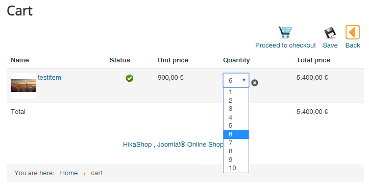

Also, I've noticed on the cart page the quantities behave like I want them to.
Below are images of my fresh test store with your modification. The product is an item with a QTY of 10.
Item example:
Cart example (note* it functions like this without the modification also):
