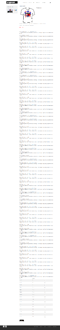

After I completed the 3.1.1 update we have some bugs it looks like.
Errors on products that did not exist before the update.
Notice: Undefined property: ProductViewProduct::$displayVariants in ....
Notice: Undefined variable: display in ...
We had to roll back the website in order to make the site usable.
I did not get a chance to test and see if there are any other issues but for the moment that seems like it.
Joomla and all other plugins were fully updated and tested before the hikashop update. Also, please note this site is very very light on plugins. The version of hikashop the site was on before I did the hikashop upgrade was 3.0.1 I believe. It was for sure 3.x.x. If you need to know the exact version just let me know and I will check the rollback.
Please look into this and let us know when we can try the update again.
Thank you
Last edit: 9 years 2 months ago by Jerome. Reason: removing duplicate content. Please use the "error" field for the error message and only the error message !
  • Posts: 86081
  • Thank you received: 14191
9 years 2 months ago #270909
Thank you for your feedback. We've added a patch on our end.
You can try again and it should not display the messages anymore.
Also note that on a live website, you should turn off the "error reporting" setting of the Joomla configuration for security reasons and thus you should not see these.
Finally, make sure you provide the full error message and that your screenshot is readable. I was able to guess the location of the issue without but I might not be so lucky next time.
