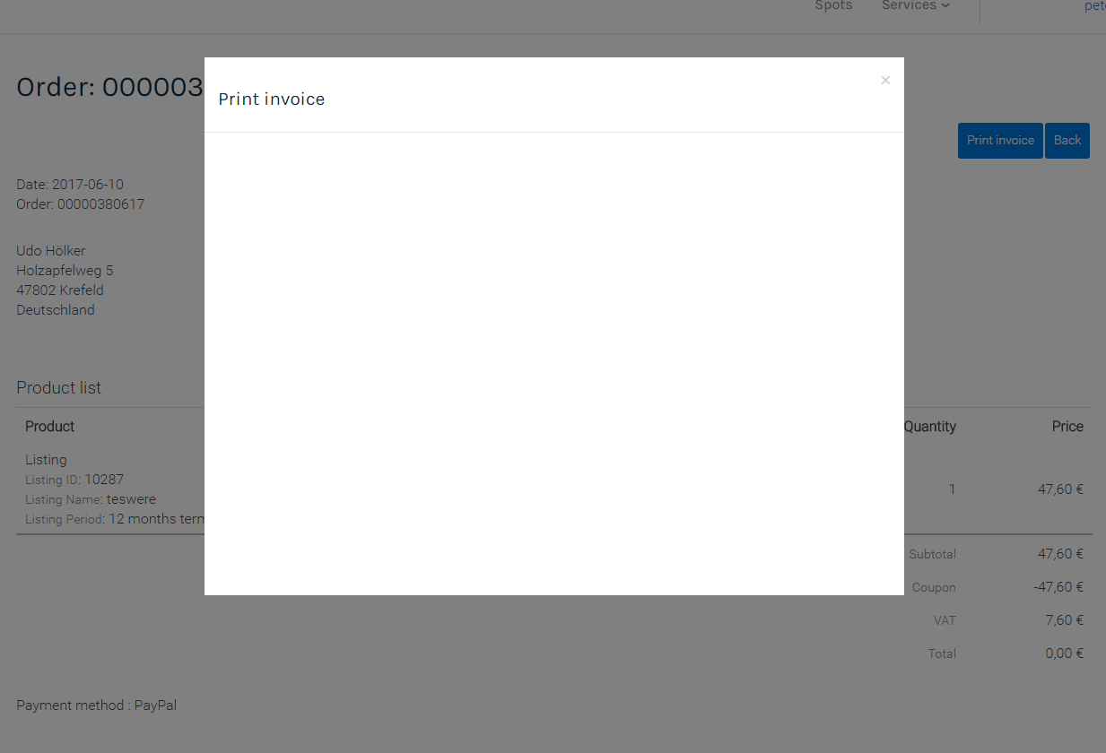

I get an empty modal when printing the invoice at component/hikashop/?ctrl=order&task=show&cid=38&cancel_url=..., see screenshot. What is that modal supposed to do? Where can I disable that?

That fix is in the plugin, I checked. But the empty modal is still there for 2 sec.

That's normal. The popup has to be there for the override to work properly. The goal of the fix is only to close the popup after the PDF download process is launched.
