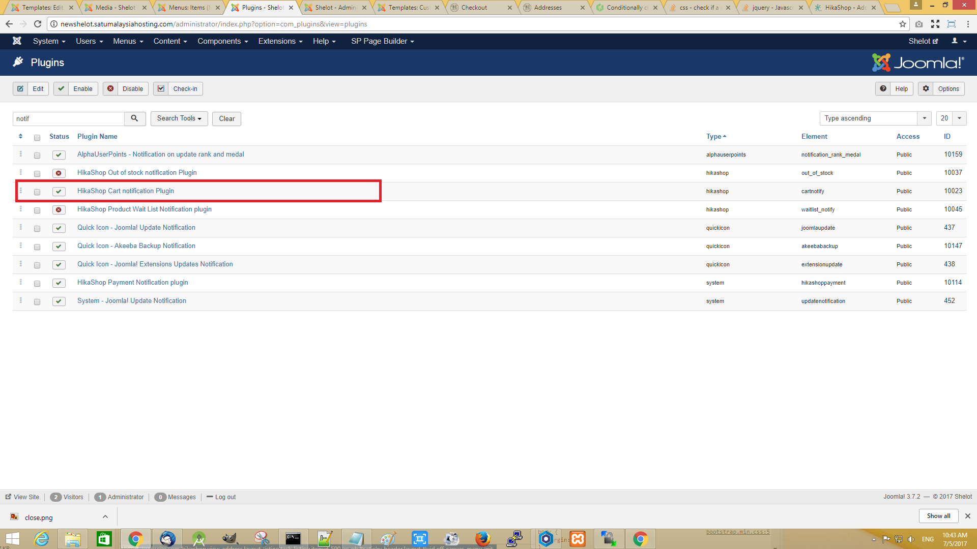

Dear Support
Why will direct go to checkout page when I click the "add to cart" button
It should click the "cart" icon, then click to proceed to checkout by right

Did you activate the "HikaShop cart notify plugin" via the Joomla plugins manager ?
That might help.
  • Posts: 575
  • Thank you received: 11
9 years 1 month ago #273339
I have enabled my cart notify plugin
  • Posts: 86081
  • Thank you received: 14190
9 years 1 month ago #273351
It looks like some kind of jQuery javascript library conflict.
Could you try installing and configuring the jQuery Easy plugin ?
That might help.
