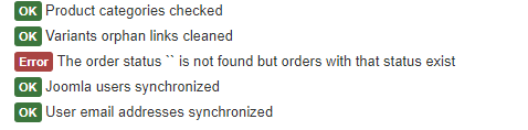

I just applied the update from 2.6.4 to 3.1.1 on a copy of my website and I notice an error on the Data base :
when I go to hikashop setup parameter there is a button to check the database. So I did it and as you can see on the file attach everything is ok except for this
Error The order status `` is not found but orders with that status exist
What does that means ? What should I do to correct it ?
  • Posts: 85883
  • Thank you received: 14124
8 years 11 months ago #274429
That means that you have one or several orders with an empty status.
HikaShop doesn't do that by default. That means that there is a problem with these orders.
They should have one of the statuses listed in the menu System>Order statuses.
But that's not a problem. It's probably just old test orders that you had and didn't clean.
You can ignore that message.
