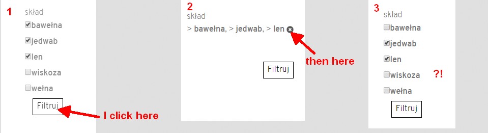

I have a checkbox product custom field filter.
If I mark 3/5 options, the filter works fine. But then there is one reset button and it resets only the first from the 3 options, and I would expect it resets all 3. Please help.

Thank you for your feedback and the details. I was able to reproduce the problem on my end. I've added a patch for it.
Please download the install package on our website and install it on yours in order to get the patch and it will work.
