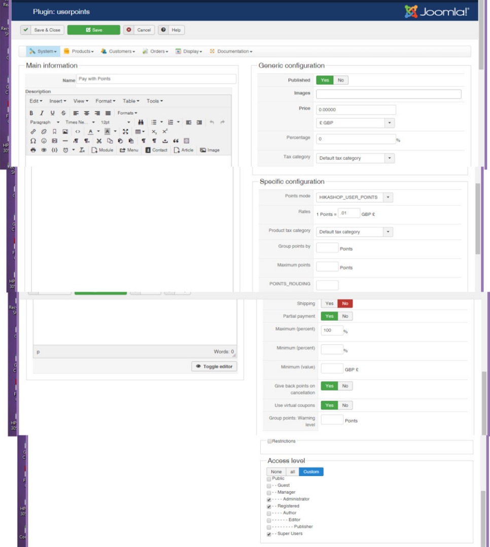

shipping gives point = no

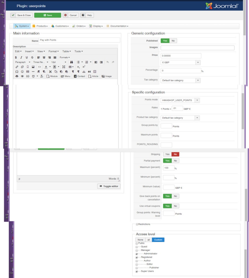

Hikashop user points payment plugin configuration -
Specific config section-
mode = Hikasho_user_points
rates = 1points=.01 GBP£
tax - default tax category
shipping = no
partial payment= yes
maximum (percent)= 100%
minimum (percent)-
Minimum (value) -
Give back points on cancellation =yes
Use virtual coupons = yes

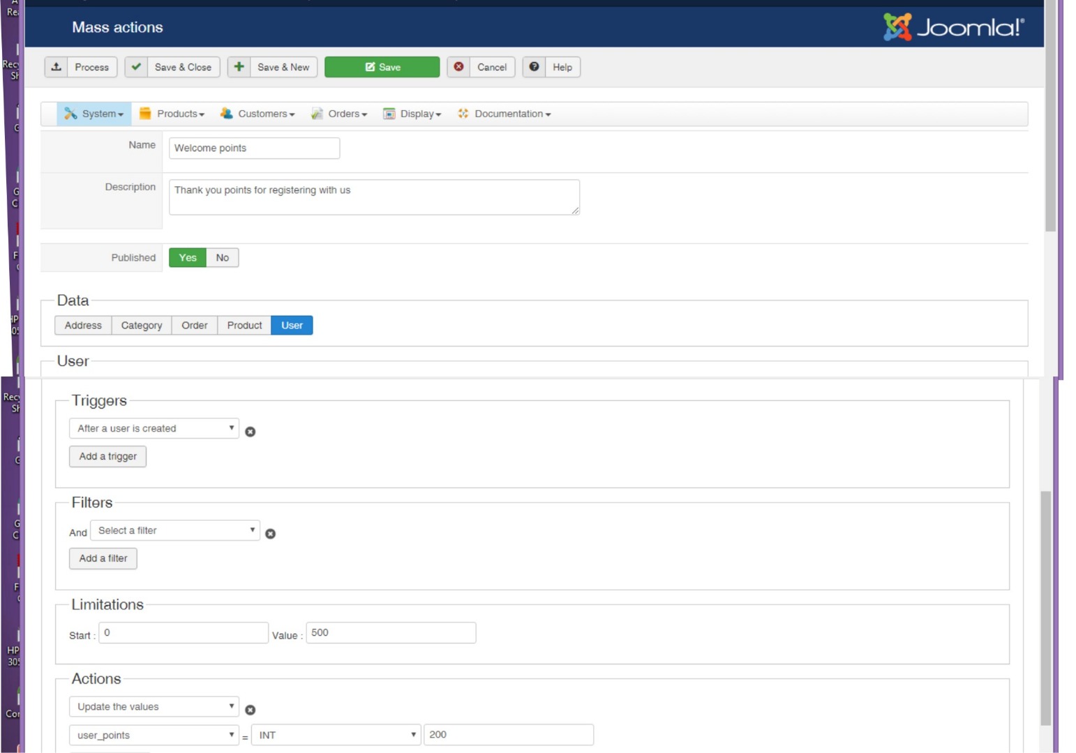

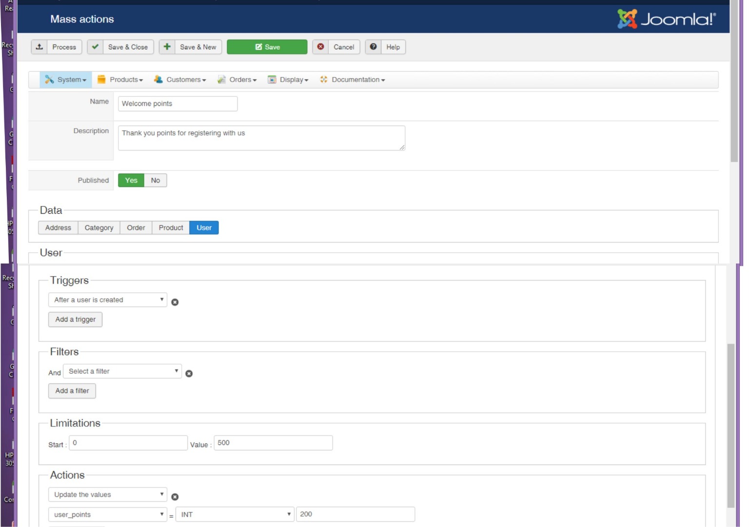

User points -mass action configured as follows:
Date=user
trigger=after a user is created
action=update the value
user_point INT 200

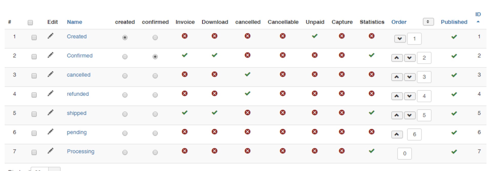

order status in screenshot
  • Posts: 26366
  • Thank you received: 4069

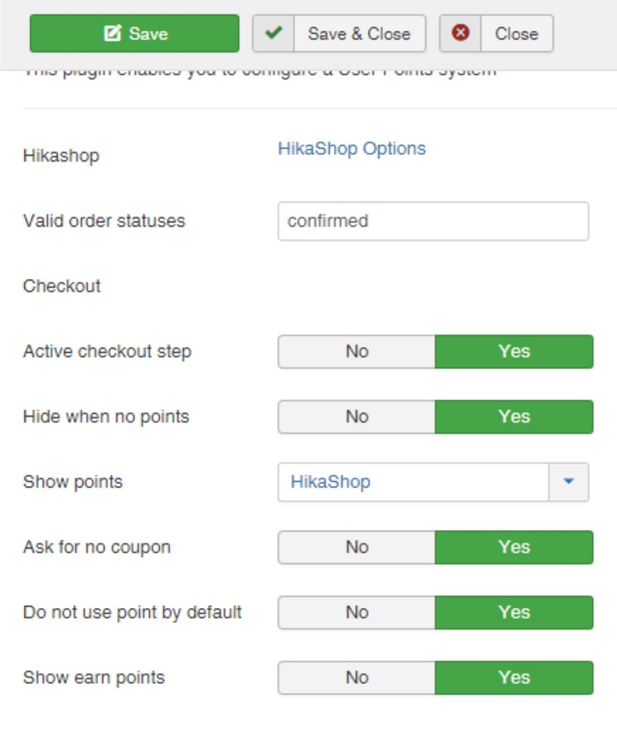

8 years 11 months ago #275803

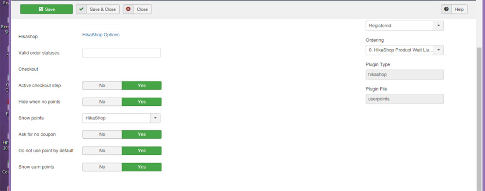

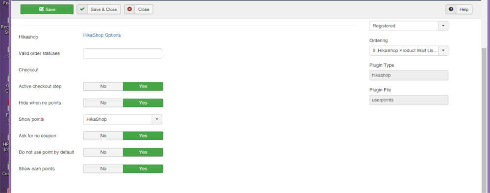

Please provide screenshots instead of text.
You can remove the setting "valid order statuses" in the Joomla part of the plugin since your order statuses are configured.
Selecting only "confirmed" can generate side effect if you're also using other statuses like "shipped" and in your case, "processing".

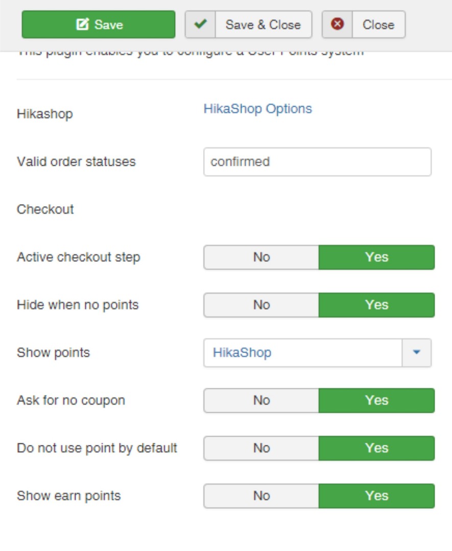

  • Posts: 94
8 years 11 months ago #275884

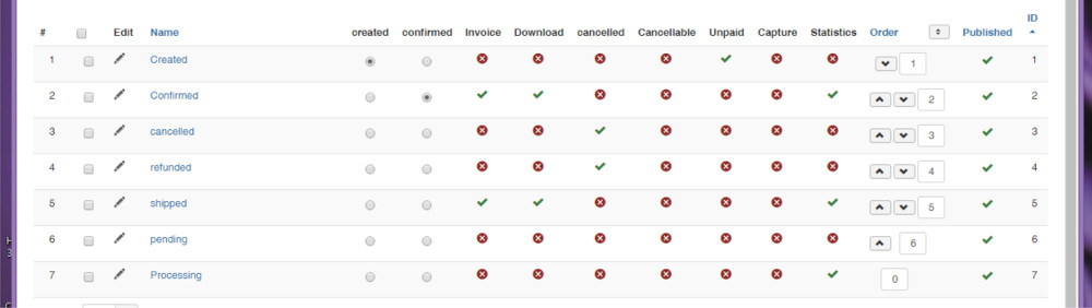

Thank you, I have made that change. Here are the screenshots

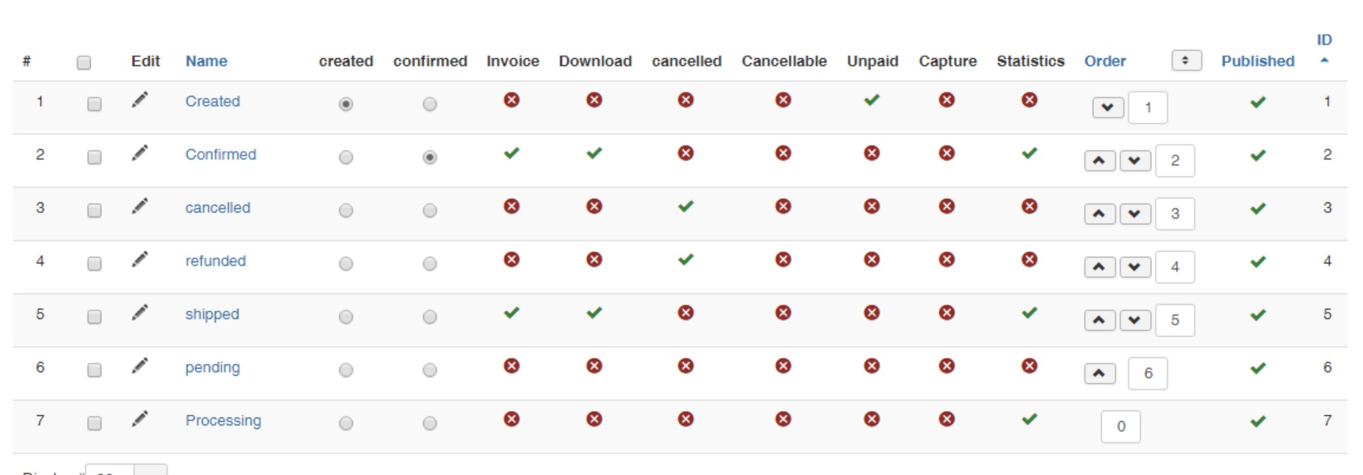

I'm not sure what you need, except the order status which I have attached here.
When the order is paid, the invoice is generated and the system marks as confirmed.
I am currently manually editing the customer's points to the correct amount when an order has been created, so what is showing in my admin section will not be what the system is giving.

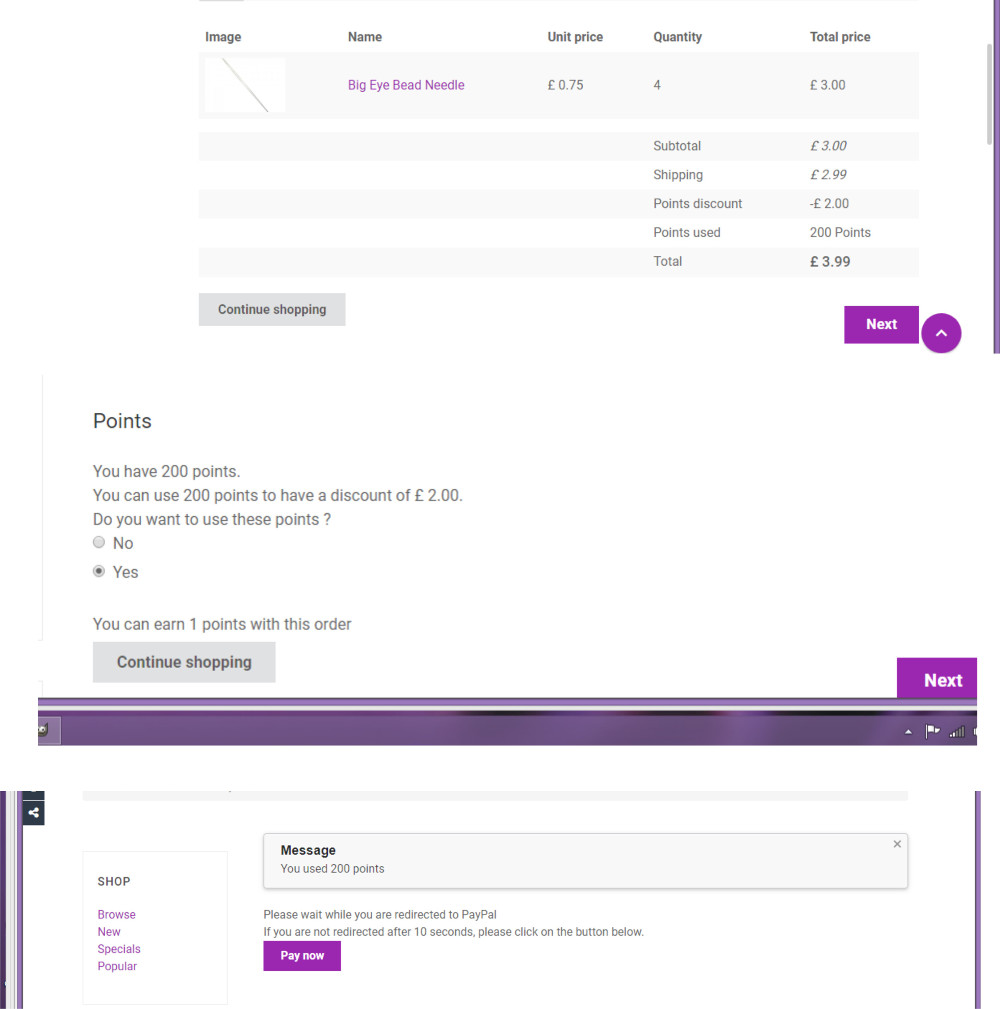

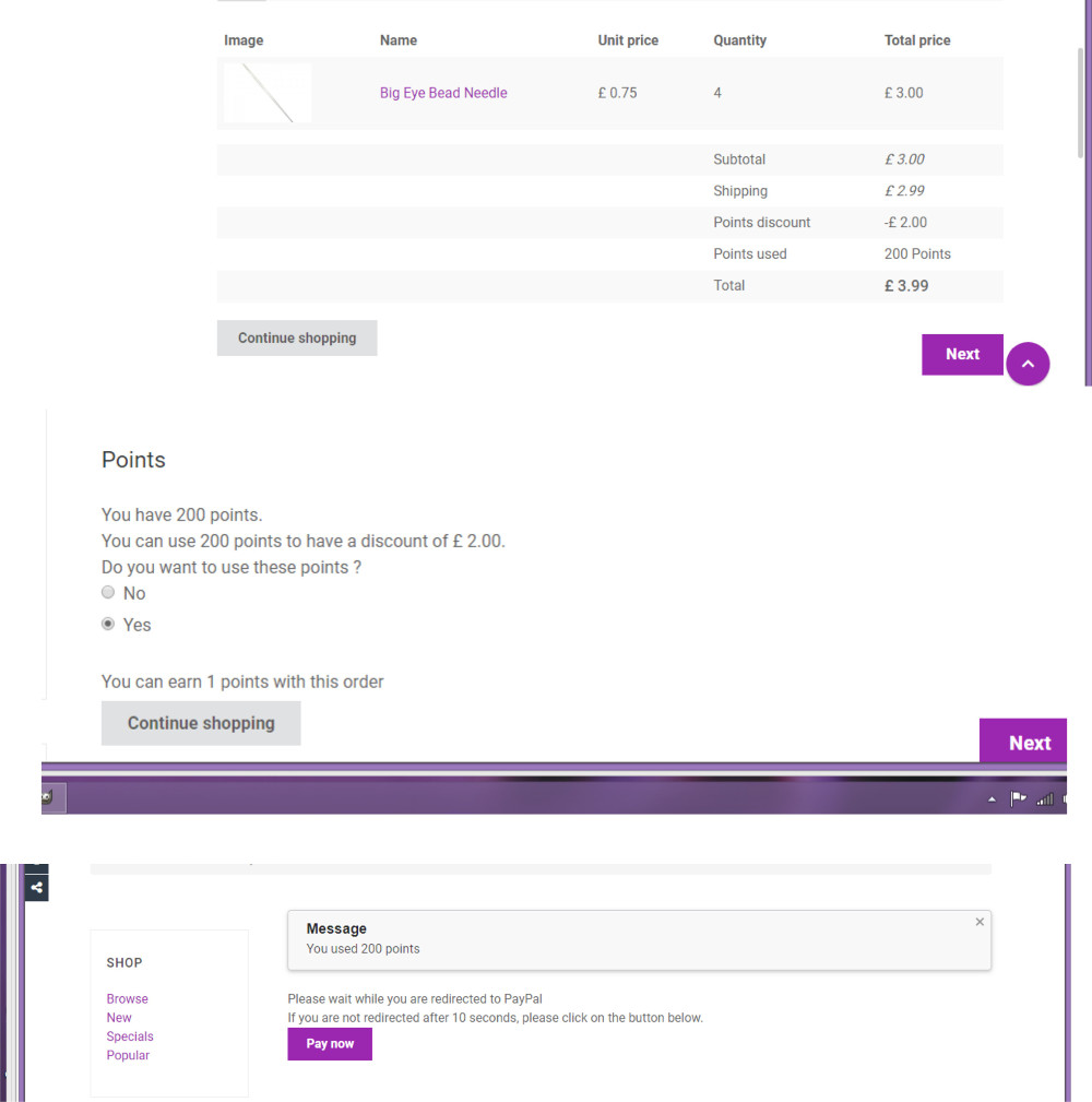

  • Posts: 94
8 years 11 months ago #275961
Ok, I think I've found it.
I've gone through and made a test order (including paying) and checked the admin area at every stage.

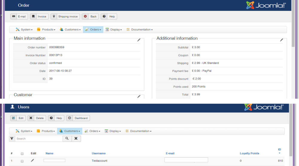

The correct points were removed when the order was confirmed,
but the new points were not added .
Upon changing the status to "processing" the points went weird - giving 199.
So, I guess I should not use any other other status?

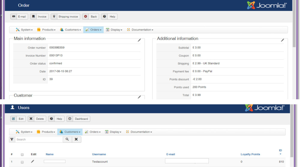

However, the new point for purchasing was not added to the account - so there is still something wrong with my set up. I've added screenshots of the front-end and back-end of the order process.

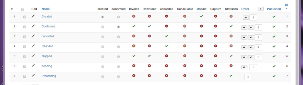

  • Posts: 26366
8 years 11 months ago #275978
You let the field "valid order statuses" blank in the configuration of the User Points plugin (Joomla part).
So the plugin is using the "invoices" column in your order statuses to determine if an order is valid or not.
That's why when you switch the order to "processing", it gave you back the 200 points but it also take back the 1 point you earned.
If you take a look at your order details in the database (PHPMyAdmin) you will see a column "order_payment_params" where some data is serialized.
That data contains the result of the points processing ; indicating how many point has been used and how many point has been earned.
The points are removed when the order is created but you earn your points only when the order is confirmed.
So the order status "created" is a bit special because it is used as transition (since you do not want your customer to create a lot of order using points but without loosing them).
That's why the plugin is making mix between "invoice" and "cancelled" in order to determine what it should do with the points.
But I think that your customer received his 1 point when the order has been confirmed ; even if you do not see the notice message in the backend or in the paypal IPN server-to-server confirmation system.

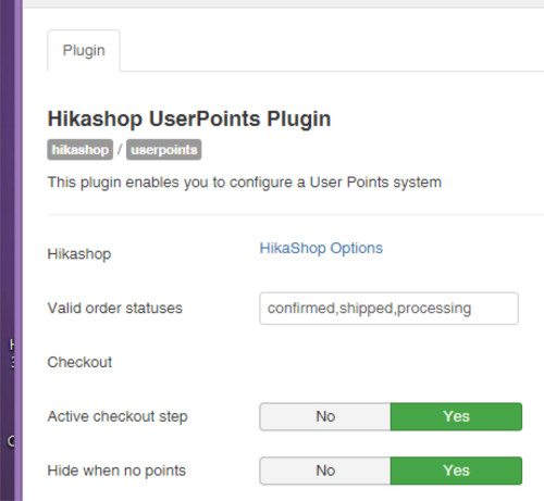

  • Posts: 94
8 years 10 months ago #276205

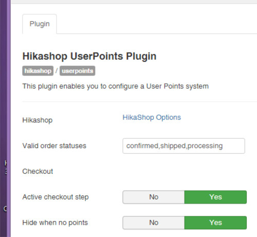

So sorry, something is still not correct.
I have put the valid order status as
confirmed,shipped,processing
The customer's points have been taken away at confirmed.
But, no new points have been added. They remain at 0.

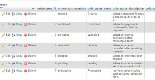

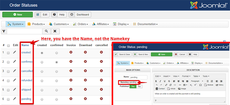

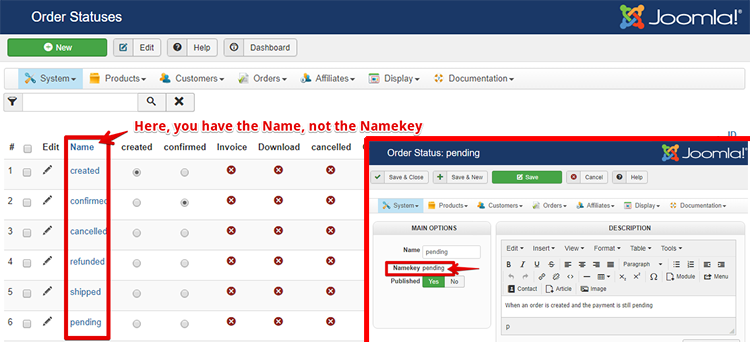

8 years 10 months ago #276227
Please note that you have to use your order statuses Namekey and not the name used for the listing.
For see each order status Namekey, you have to edit required order status like this :
Check that what you write in plugin input text fit all Namekey.
Last edit: 8 years 10 months ago by Philip.
  • Posts: 94
8 years 10 months ago #276292

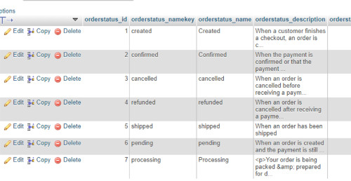

yes, having checked, these are the namekeys
I think I may have found where the problem lies
1 order overnight did not add any points to the existing total. Customer paid with PayPal, did not use any points
1 order overnight removed used points, did not add any. Customer paid by PayPal.
(these use the HikaShop Paypal payment plugin)
1 order overnight removed used points, and added - this customer paid by credit/debit card - using the HikaShop PayPal Pro payment plugin
The status of all three orders is confirmed.
Invoice numbers for all have been generated.

  • Posts: 94
8 years 10 months ago #276508
I apologise, I did not realise that you wanted this information from the database, that was not made clear.

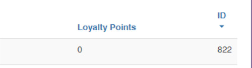

I did look at the "order_payment_params" - of course this serialised information means nothing to me. I could not see anything to indicate why they are not on the user's account.
Here is information from the database from two orders - the first which worked correctly, the second which did not. Both orders are still at 'confirmed' as I don't feel that I can change them to 'shipped' as it will probably change them again.

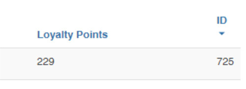

Correctly added- the account shows 42 (order id 725)
O:8:"stdClass":1:{s:10:"userpoints";O:8:"stdClass":4:{s:10:"use_points";i:200;s:11:"earn_points";a:1:{s:2:"hk";d:42;}s:8:"use_mode";s:2:"hk";s:9:"give_back";b:1;}}
(payment id - 5)
incorrectly added- the account shows 0 (order id 822)
O:8:"stdClass":1:{s:10:"userpoints";O:8:"stdClass":4:{s:10:"use_points";i:200;s:11:"earn_points";a:1:{s:2:"hk";d:4;}s:8:"use_mode";s:2:"hk";s:9:"give_back";b:1;}}
(payment id - 1)
both have a status of confirmed
Now, the only thing here that I can see as different is what I assume are the number of points. This does not show why those points are not on the user's account.
I agree, there must be something incorrect with either my status or perhaps payment method. As I explained, I have noticed when the payment used the PayPal pro plugin (entering card details), it has appeared to have worked. When the payment used the standard Paypal plugin it does not. That may be a co-incidence of course.
Here is the screenshot of my status namekeys, and my plugin after you advised me regarding the commas and spaces. I have also included the shown user points in the admin are for the above examples.
If you still require more information, I will gladly supply it, just ask.
