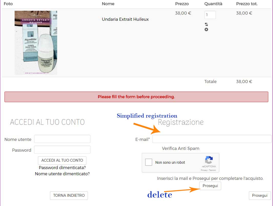

Hi, as in the attached image, I would like to remove the button continue to simplified registration during the purchase process and leave just the button continue, last below, so that you log the mail and go to the next page where you can complete the order, you can do this?
  • Posts: 26366
  • Thank you received: 4069
8 years 10 months ago #276249
I think that the easier would be to add a little CSS rule in order to hide that specific button (via a "display: none").

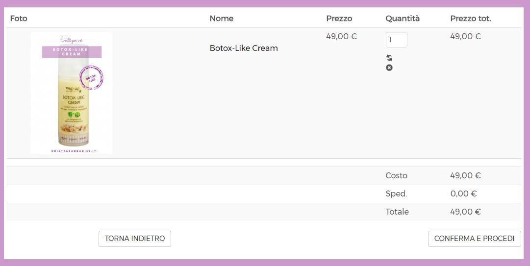

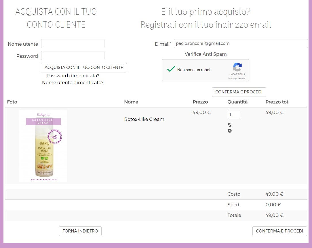

One last thing, at the moment I adopted this escamotage, the only thing that goes on, I still leave the cart (which I deliberately showed in the first part), I would rather that the billing, shipping, payment as second and last section Part and then avoid the cart appearing 2 times. I attach the images to better understand, thank you again, I hope it can be a quick change

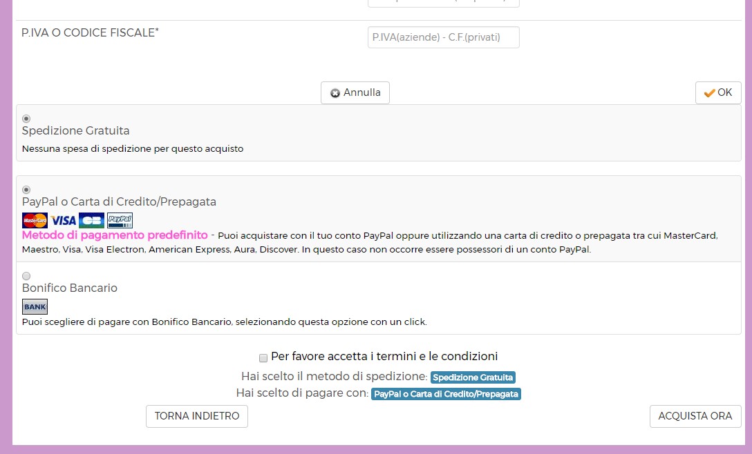

I try to explain better. I would like as an attachment in the previous message, have 2 steps for the purchase process and not 3 as it is currently on the site.
Currently the purchase configuration is this:
1st step: Log in or register, the carriage and Continue
2nd step: Leave the cart still and continue
3rd Step: Billing / Shipping Information, Shipping, Payment, Accept Terms and Confirmation
I wish that the 2nd step was eliminated, I hope to have been clearer.

  • Posts: 85883
  • Thank you received: 14124
8 years 10 months ago #276352
There is no cart only second step.
Normally, if you register/login and it doesn't change anything to the cart being displayed, it should automatically go to the next step if you click on the main button at the bottom to go to the next step.
So either:
- you have something changing in the cart when you login/register (like the shipping fee), and in that case there is no solution if you want to keep the cart and the login on the same step.
- you are actually not using the main "next" button at the bottom but the "register" / "login" button of the login view which will send the login/registration form and log you in. The cart will still be there until you click the "next" button at the bottom. In that case, just hide the "register" / "login" button of the login view, as Jerome proposed in a previous message with some CSS. That way, the customer will have to click on the "next" button at the bottom and it will do the login AND go to the next step in one action.
