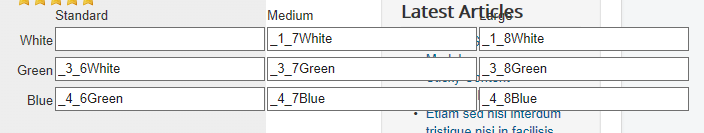

  • Posts: 43
8 years 10 months ago #276683
Hi and thanks for your reply.
Right now is how to set the default. With a name in this line
have made a name2 = ''.$value->characteristic_value;
if($this->characteristics[$value->characteristic_parent_id]->default->characteristic_id == $value->characteristic_id && !empty($this->characteristics[$value2->characteristic_parent_id]->default->characteristic_id) && $this->characteristics[$value2->characteristic_parent_id]->default->characteristic_id == $value2->characteristic_id)
I surpose that is the reason that the first box is with no name and
You can see it her www.screencast.com/t/eWr9sFxAzP
when that is done can 1 made a class for the $name2 and hide the vaule of other classes
Reagrds

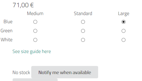

  • Posts: 43
8 years 10 months ago #276760
Hmm that´s wird i do not get the delete2.png in my table if a prodouct not are on stock - see image ?
How ever what i want is replace the radio button with a box with the size in as showed eairler.
And as told i am pitty close, just need to inset the $name2 = ''.$value->characteristic_value; in the lines below so it shows the name i the default color/size combination.
Have tried some combination with out success

  • Posts: 43
8 years 10 months ago #276805
Here is what my founding are so far.
Have added the line $name2 = ''.$value->characteristic_value;
And added this in $name = '_'.$value->characteristic_id.'_'.$value2->characteristic_id .$name2;
Then i have change the input type from "radio" to "btn"
$radio = "\n\t<span class=\"hikashop_product_characteristic_span".$classspan."\"><input type=\"btn\" class=................
By this i got the reasult as you can see on the image.
As you can see at the image now is show the value of the characteristic (size) inside the btn, however, as you see in the first one there are no characteristic, and i suppose the reason for that there is there are missing the value field in this line.
if($this->characteristics[$value->characteristic_parent_id]->default->characteristic_id == $value->characteristic_id && !empty($this->characteristics[$value2->characteristic_parent_id]->default->characteristic_id) && $this->characteristics[$value2->characteristic_parent_id]->default->characteristic_id == $value2->characteristic_id) {
$radio .= ' checked';
If i am right can is give the $name2 it own class, the by that ajust the btn with css
I know it might not be the classic way but i might works until you come with html table solution as you concider to do
