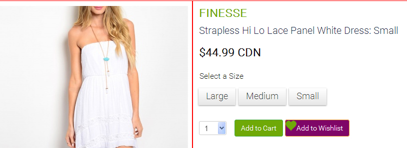

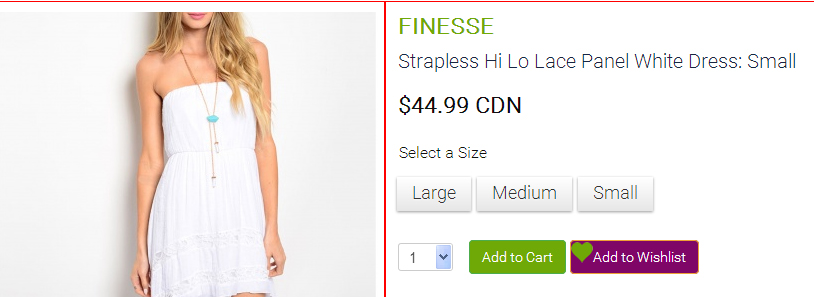

I am talking about all products that will have a dropdown. I would like the dropdown to show the quantity of that product or product option. For example, say the item below has 2 small, 3 medium, and 5 large, when the user clicks on a size the quantity of that size will show in the dropdown.
So if they click on small, it will show:
1
2
If they click on large, it will show:
1
2
3
4
5
Etc....
