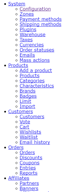

When I click on Components > HikaShop, it looks like the attached. I don't think that's how it should look?

This looks like a fatal error. Activate the debug mode and error reporting of the Joomla configuration and try again. You should then get an error message at the bottom of that page which will help us understand what's going on.
