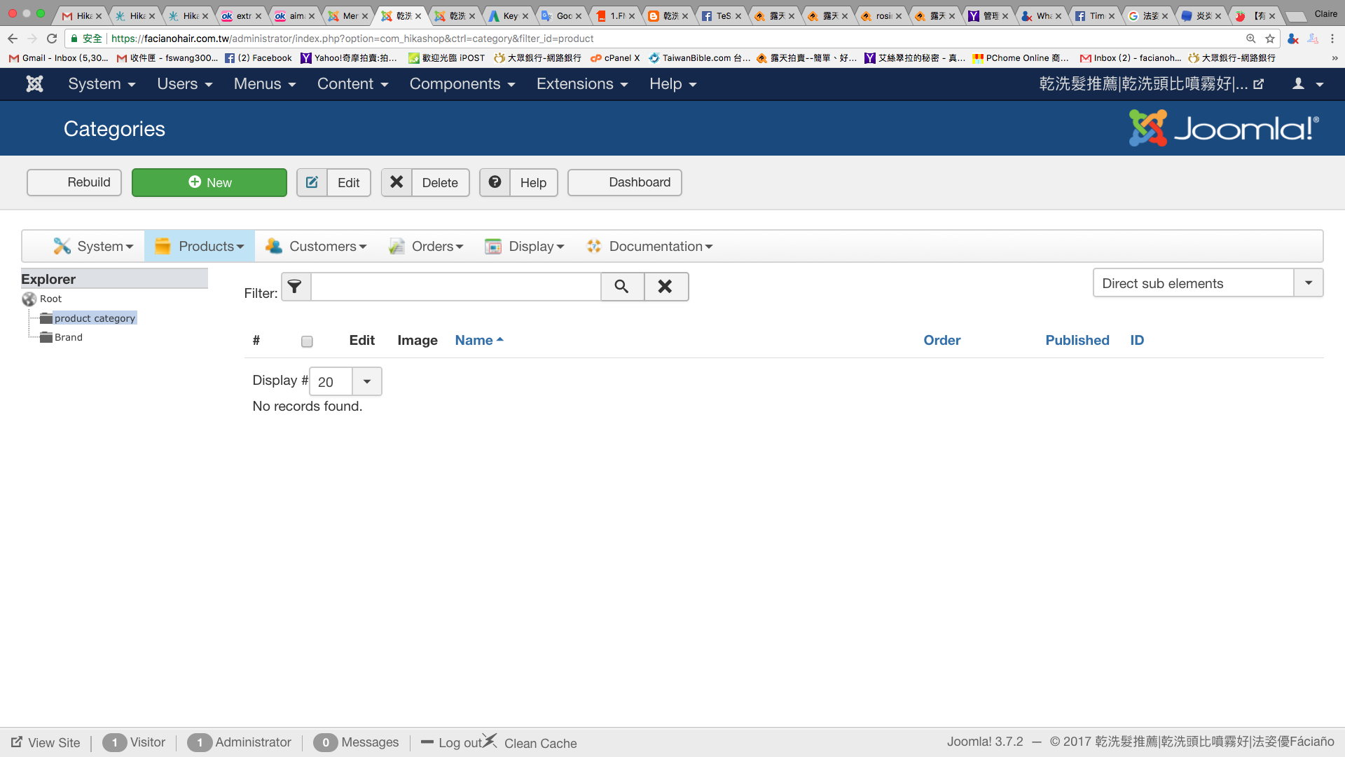

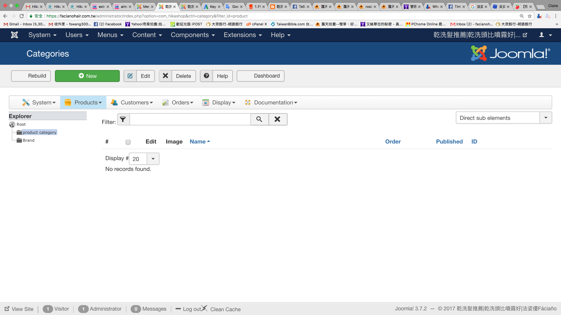

  • Posts: 220
8 years 9 months ago #280438
Please see the attachment, thank you very much.
  • Posts: 26381
8 years 9 months ago #280460
Yes, you do not have any "sub category" but you do have a "product category".
You can't create a product without a category ; so your products are still in a category, even if you did not create it yourself. Right ?

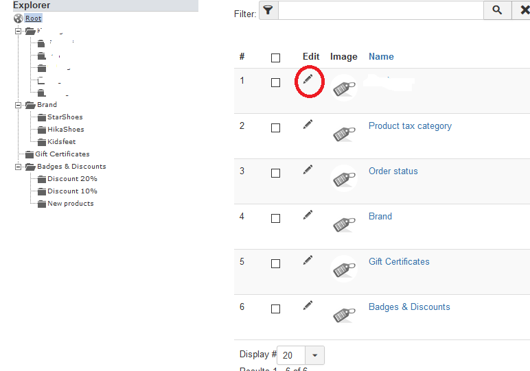

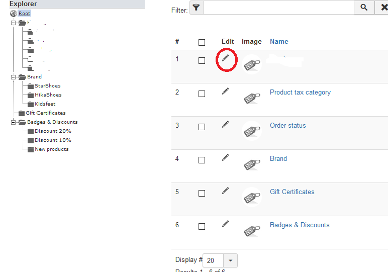

  • Posts: 1119
  • Thank you received: 114
8 years 9 months ago #280484
I think the issue is that hikashop has a tricky edit button if you don't know it.
Please press root category and then edit icon near your product category. You will be able to edit meta description there. Screenshot attached.
Hope that helps.
