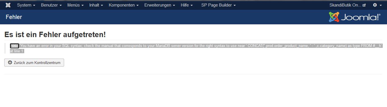

-- Error-message(debug-mod must be tuned on) -- : 1064 You have an error in your SQL syntax; check the manual that corresponds to your MariaDB server version for the right syntax to use near ' CONCAT('',prod.order_product_name, ' - ' ,c.category_name) as type FROM #__h' at line 1
I was in the control panel of Hikashop and tried to edit the window "sales of the month", because it shows nothing, but have orders.
But suddenly I get this error message when I click in the control panel of Hikashop.
screen: imgur.com/a/mO6F4
What can I do? I need urgently help please.
Thanks in advance
Simone
8 years 9 months ago #281784
Like that it's difficult to know what is the SQL error exactly.
But I have to guess that it might be related to the "type" alias.
So you should edit the HikaShop "widget.php" class and replace the line:
$fieldtype.=' as type';
by
$fieldtype.=' as `type`';
And I hope that it would fix the issue.
  • Posts: 35
8 years 9 months ago #281832
Thank you for your response.
Unfortunately, it didn't fix the issue.
Now the error differs a little:
1064 You have an error in your SQL syntax; check the manual that corresponds to your MariaDB server version for the right syntax to use near ' CONCAT('',prod.order_product_name, ' - ' ,c.category_name) as `type` FROM chdg4' at line 1
Could you help me if I would give you access to the backend?
Simone
  • Posts: 35
8 years 9 months ago #281860
hi,
I could solve the problem.
There must be an error in the report: Sales this month.
I removed this report and after that it worked again and I could create a new report: Sales this month.
Simone
