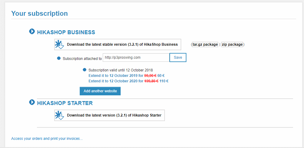

  • Posts: 14
8 years 9 months ago #282424
The Subscription is good until October of 2018:
  • Posts: 86081
  • Thank you received: 14190
8 years 9 months ago #282427
Yes but no.
You're looking at the subscription for the website p3proswing.com which is attached to the website p3proswing.com with the user account SVT, while you're trying to update on the website p3proswing.com/site3 for which there is a subscription which expired in march and which is attached to the user p3.chuck
Change your subscription to p3proswing.com/site3 in your account SVT and refresh the updates on that website and it should then work.
The following user(s) said Thank You: SVT
  • Posts: 14
8 years 9 months ago #282460
Awesome.. That did the trick :-)
