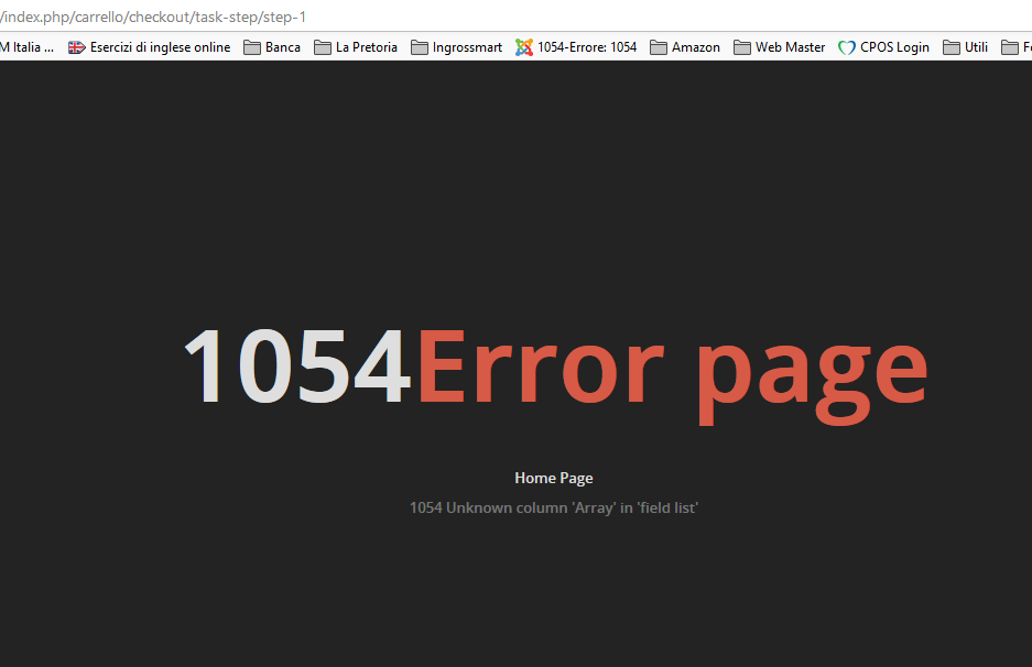

8 years 9 months ago #283163
-- Joomla version -- : 3.8.2
-- PHP version -- : 7.0.1
-- Browser(s) name and version -- : mozilla
-- Error-message(debug-mod must be tuned on) -- : 1054Error page
Home Page
1054 Unknown column 'Array' in 'field list'
in my site have this problem in checkout.
1054Error page
Home Page
Last edit: 8 years 9 months ago by fertad69.

  • Posts: 9
8 years 9 months ago #283174
I have the latest stable version of HikaShop Business: 3.2.1.
228/5000
I have activated both "debug mode" and "error reporting", but the error page after order confirmation is always the one for which I sent the screenshot. I've also turned off legacy Checkout but the result is always lost.
If I can send you an account privately to be able to personally verify the problem I would be grateful to you.
