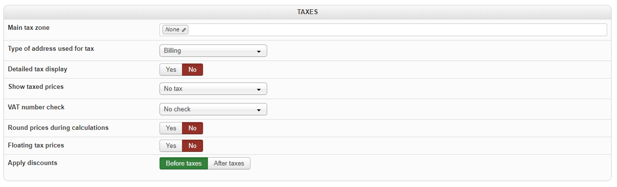

Can you please check your settings for the HikaShop taxes ?
There is a parameter to perform a VAT number verification (which can be made with a format or an online check).
If the feature is activated, it could alter the content of the VAT number.
Afterwards, some screenshots regarding your tax configuration (and taxes configurations) would be useful in order to understand the global situation and give you a more accurate answer.

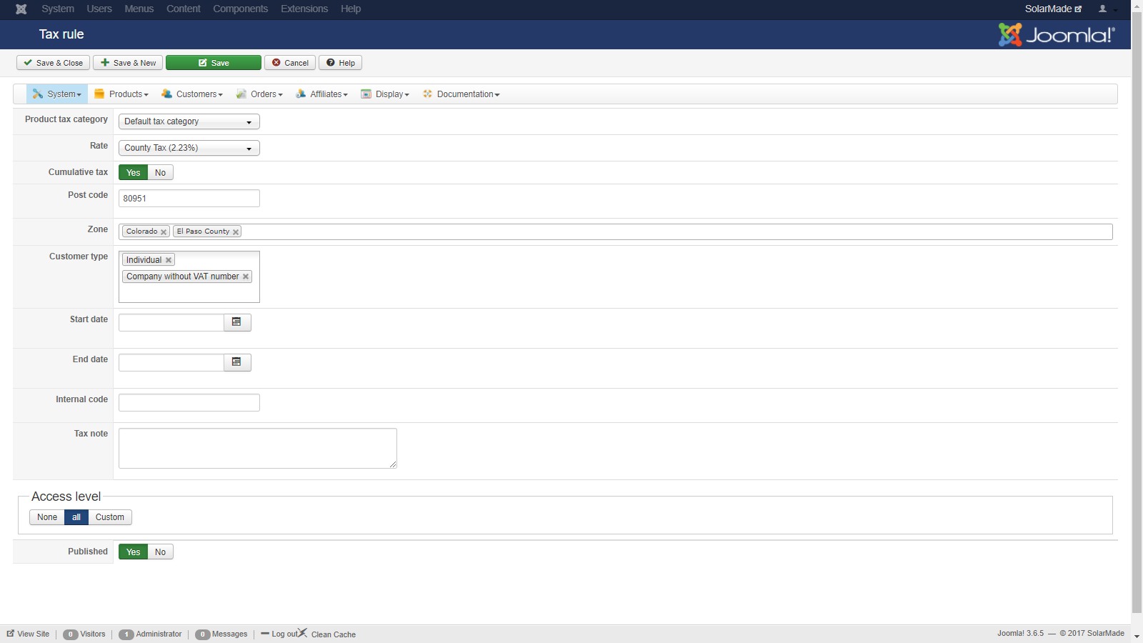

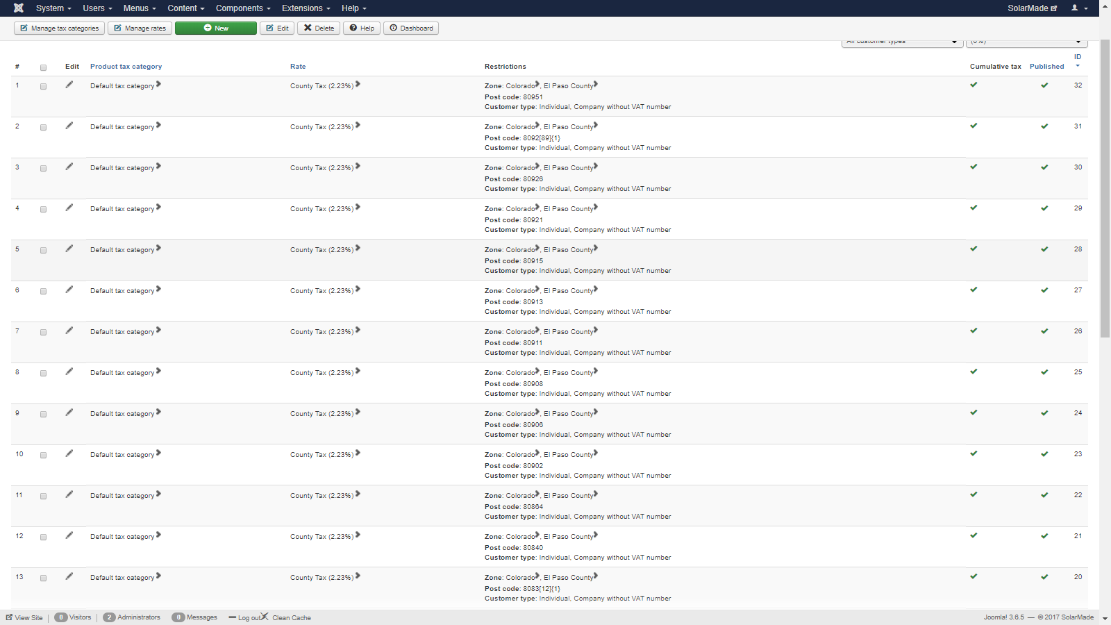

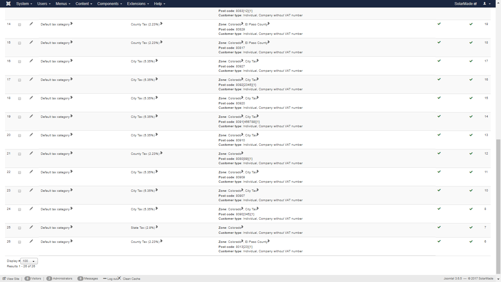

Jerome,
I have tried setting the VAT number verification to no check, format check, and online check with no results, it just will not remember the VAT number when entered. Attached are screenshots of our tax configuration and tax rules. All of our tax rules are set to cumulative tax, if that would even have anything to do with it.
